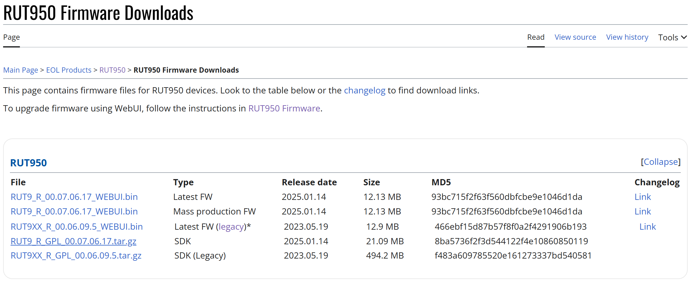

The first step is to upgrade your legacy firmware to the latest version, RUT9_R_00.07.06.17, using the Bootloader’s menu. This method is the most secure and reliable way to transition from legacy firmware versions.

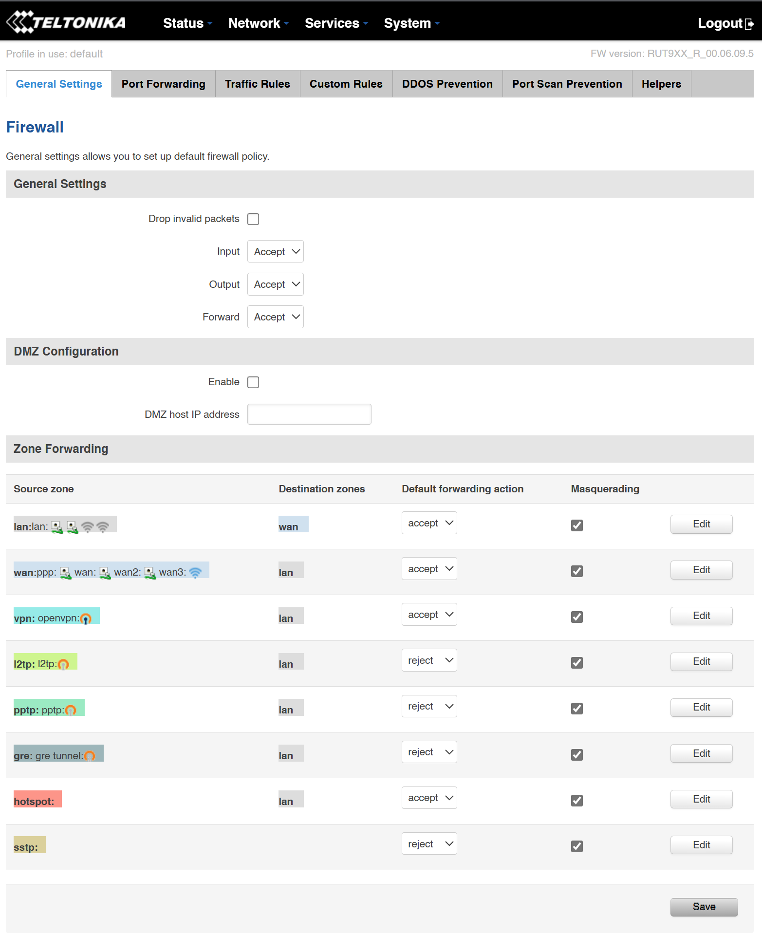

Could you provide a screenshot of Network → Firewall → General Settings → Zones? To allow traffic from LAN to WAN, ensure the following policies for LAN zone are enabled:
  • Input: Accept
  • Output: Accept

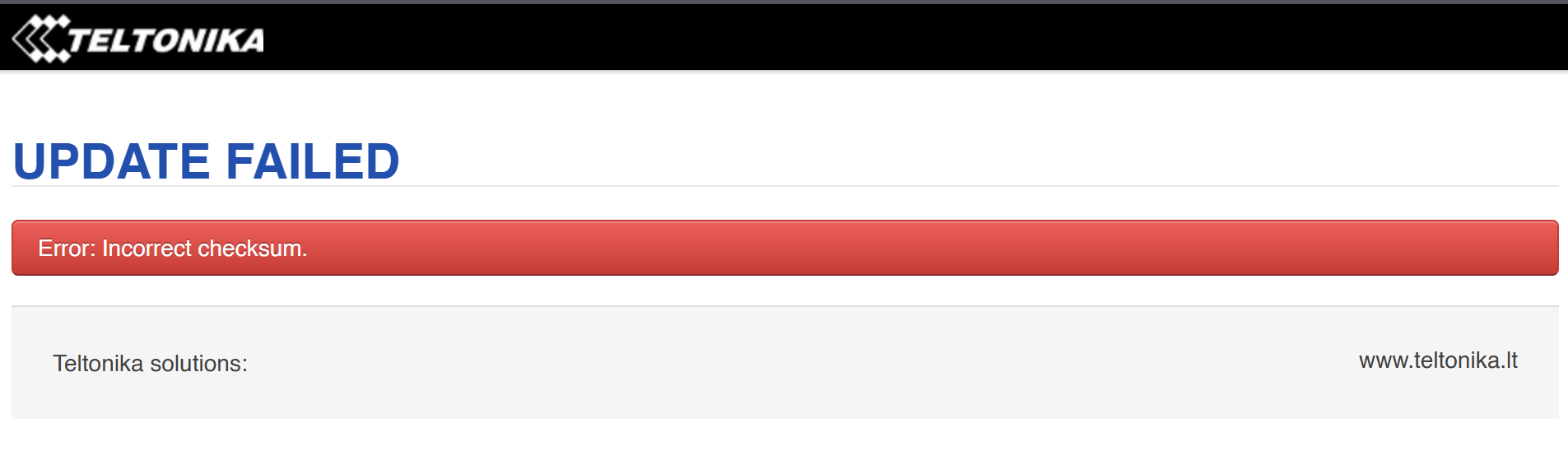

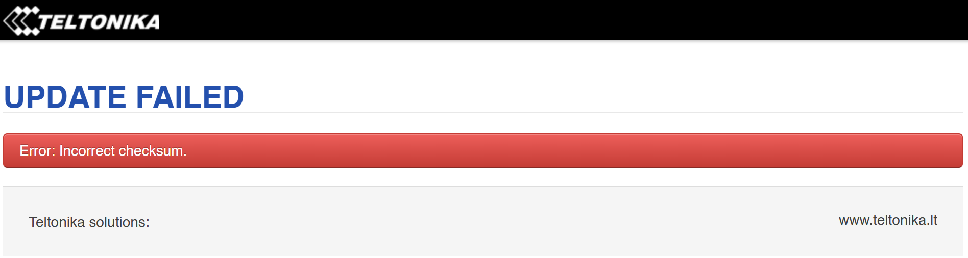

It seems there is a checksum error
I think i downloaded the correct one
I downloaded the latest one

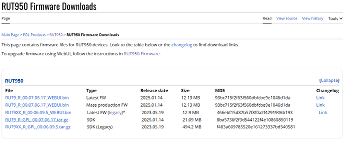

Thank you for your update. Could you clarify which firmware file you downloaded? It should be a .bin type file and can be downloaded directly from here: RUT9_R_00.07.06.17_WEBUI
If you encounter issues uploading it via the Bootloader menu, please try uploading it through the WebUI by navigating to System → Firmware and selecting the file there.

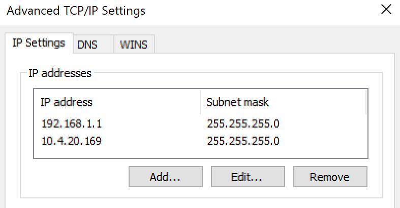

My IP settings

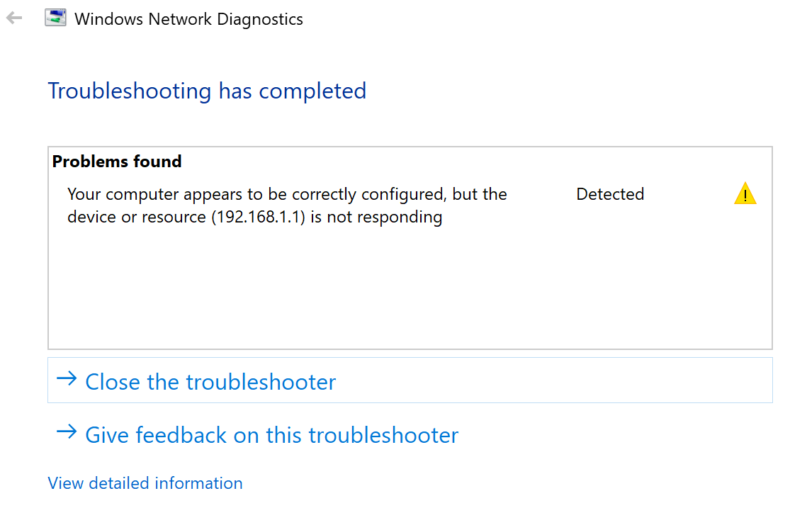

The LAN side IP should be 10.4.20.2 for the device
I see my issue, my ip was set to 192.168.1.1

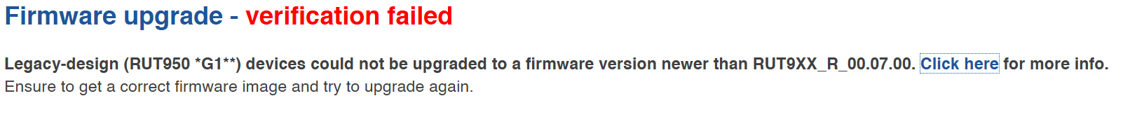

I downloaded the one in the link you gave, it still fails
Cant access via putty or webUI
I now tried using the FW upgrade tool in the webUI, it says the device is incompatible with the new FW

Here is the Firewall rules
Still no internet access for LAN devices

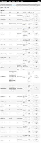

Edit:

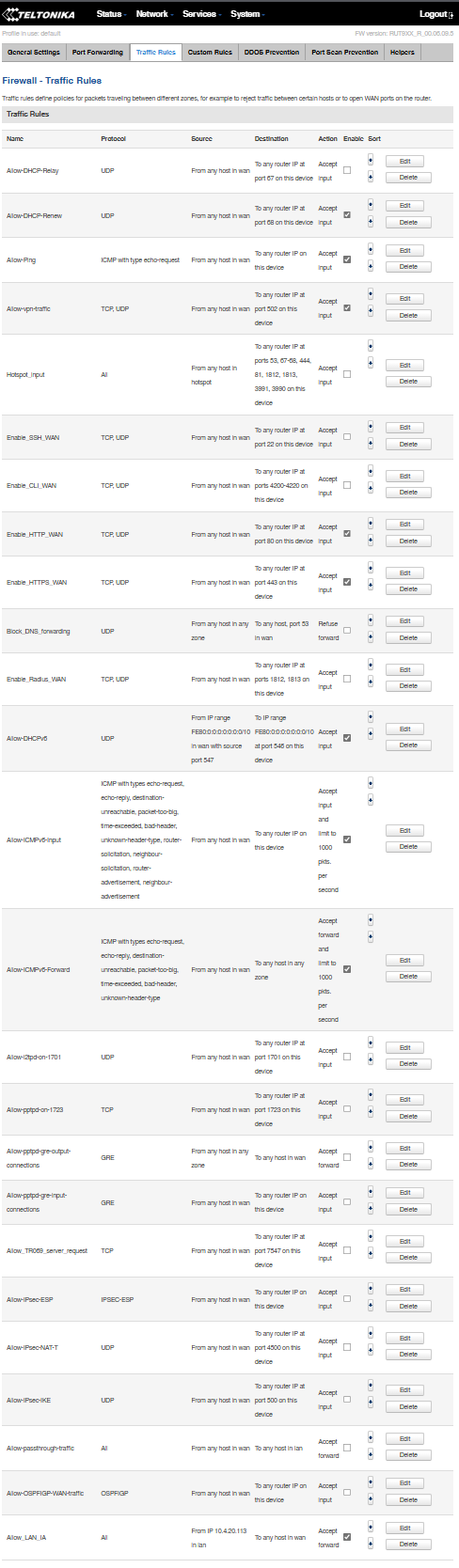

Here are the traffic rules.
Seems i have hit reply limit

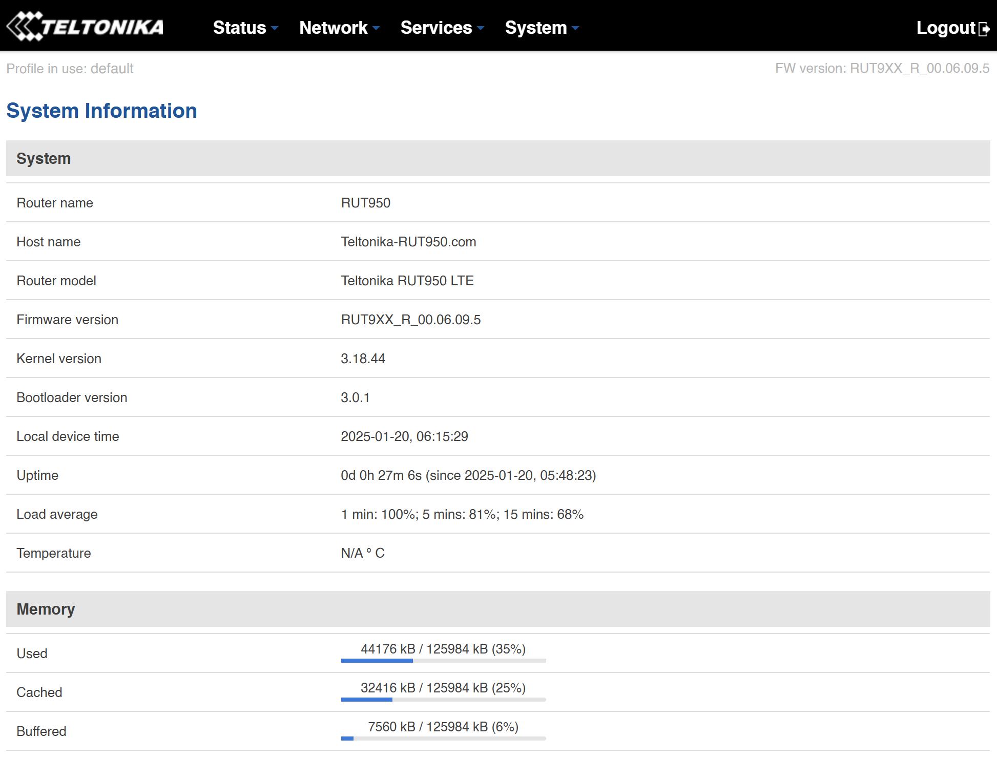

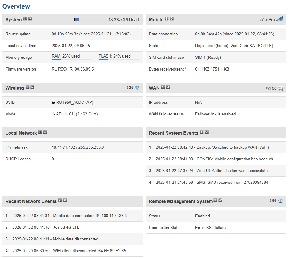

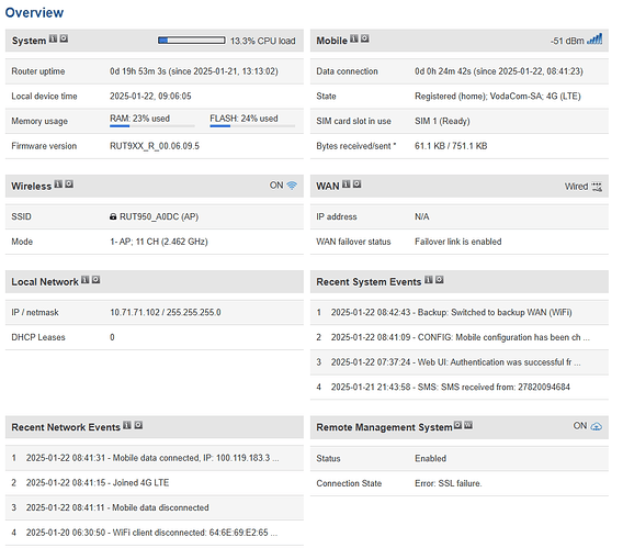

Could you please confirm the product code of your RUT950? You can find it in Status → System. If the product code is RUT950XG1XXX, then the device will not support upgrading RutOS firmware from legacy versions to the newer ones.
Additionally, could you verify the following:

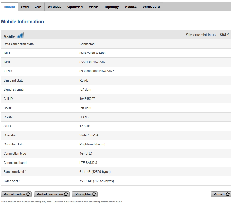

  1. Does your device has an active internet connection (via wired, mobile, or wireless WAN)?

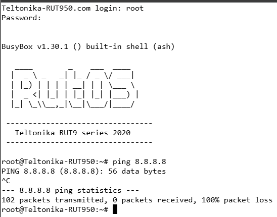

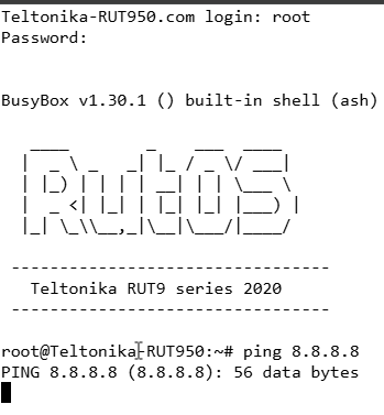

  2. Can you ping 8.8.8.8 from the router’s CLI or using the diagnostics tool from System → Maintenance → Troubleshoot section?
Product code: RUT950UG1XXX
    Yes, the RUT used to have a WAN connection aswell but now only a Mobile connection is present.
After “ctrl + c”:
