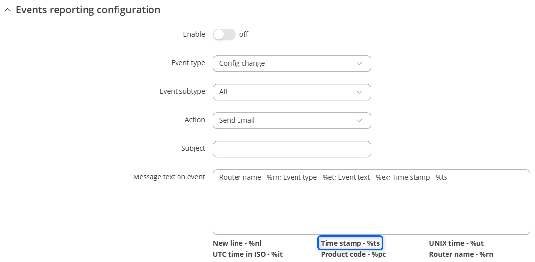

Good afternoon,
If you are inquiring, about receiving text message alerts, you can configure them in such a way, where you would receive a time stamp, along with other configurations (See screenshot attached)
In addition you can read more about the functionality in this link : https://wiki.teltonika-networks.com/view/RUTX11_Events_Reporting
If this does not resolve your issue, please advise more on your use case, your topology, what information you are sending.

Good morning Arturas,
thanks for your reply, it works but doesn’t solve my situation because unfortunately is a little bit more specific, let me explain.
I saw that Events (and others technical sections that can send SMS) could use system tags like “%ts” (which "value"of the time is exactly what I need)
Unfortunately I need to use the “Alarms Configurator” in MODbus TCP Client section (only way I found to send SMS on a MODbus TCP Client Read Poll Request).
The problem is that the SMS Text Message box (in this section) doesn’t allow system tags like “%ts” or whatever time-value (using or not characters like “” , - and so on).
It is maybe some technical notation I can use to get time value in this situation?
