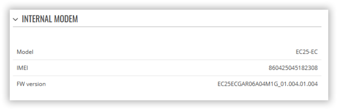

I have the modem version of the attachment, is there another newer version?

Just to confirm, the connection is functioning correctly after you reset the device to its factory settings, correct?
As for the modem’s firmware, it’s generally not advisable to update it unless you’re experiencing problems connecting to your mobile operator. Therefore, if the connection is working fine following the reset, I recommend avoiding any updates to the internal modem’s firmware.

thanks for the info of modem firmware.
