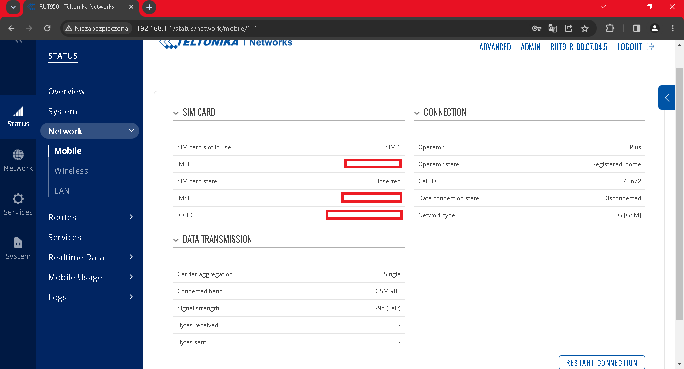

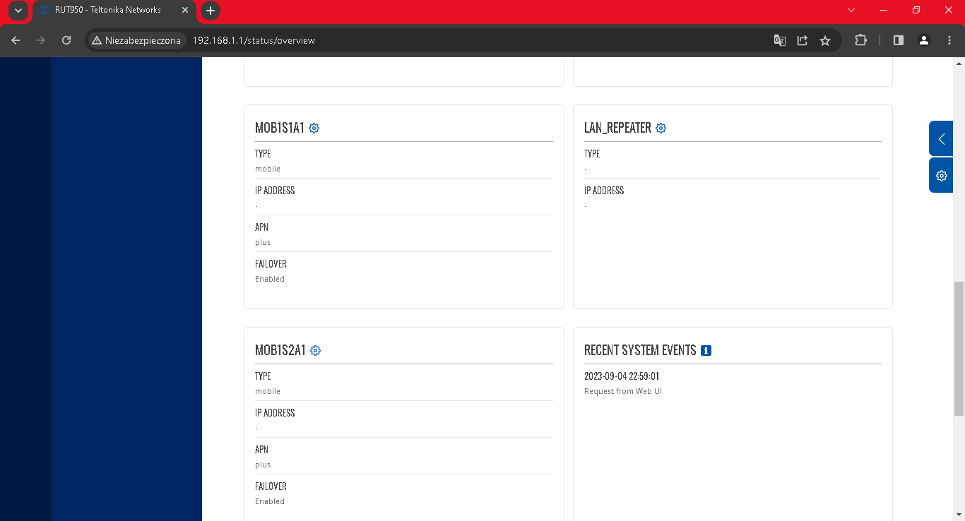

Would it be possible for you to also post two screenshots, please? One from the Status → Overview page, and one from Status → Network → Mobile. Please, blur/hide any sensitive information, such as public IP addresses, IMEI, IMSI, etc.
Sorry, as a new user I can only post one picture at a time.
It is hard to say what the exact issue is because the device is connected to 2G. Could you please ensure that the antennas are properly attached and then try setting network type to 4G in Network → Mobile → General → Network type. Also, if possible try moving the device closer to the window.
Does it connect to the operator on 4G?
I managed to connect to 3G with 3 bars of connection range, but the Data Connection still says “Disconnected”.
At the place where router is located, 4G is not available.
A few things:
  • Double-check that mob1s1a1 interface is not disabled in Network → Interfaces
  • Check if RUT950 connects with a different SIM card (from a different operator).
  • Ensure that the SIM card is allowed to be used with routers (like hotspot).
  • Insert the SIM card into the phone and check what APN it uses. Then, try setting the same APN manually on RUT950.
  • Since you have updated the firmware at some point, try restoring the device to factory defaults in System → Backup.

ad.1. Interface mob1s1a1 is enabled.
ad.2. Router works correctly on my other SIM card.
ad.3. That I am not sure of for now.
ad.4. Already tried that - the APN is always: plus. Didn’t work.
ad.5. I did the factory reset in the beggining.

Do the logs say anything about this problem?
Do I understand correctly that when you are using this SIM card in your phone, the phone connects to 2G/3G as well, and not to 4G. Correct?
In this case, I would suggest trying to update the modem following the instructions provided earlier.
Yes, the phone connects both on 2G and 3G and works just fine.
I’ll try to update the modem.
Updated to EC25ECGAR06A15M1G_20.200.20.200.
Still nothing :frowning:
Would it be possible for you to maybe test it in a different location where 4G is available and then share system logs again? Because right now the device is unable to obtain an IP address. You can try switching the PDP type to IPv4/IPv6 on the mobile interface. While it’s unlikely that this will resolve the issue, it’s worth a try.
Also, could you please share a screenshot of your configurations on the mobile interface?
