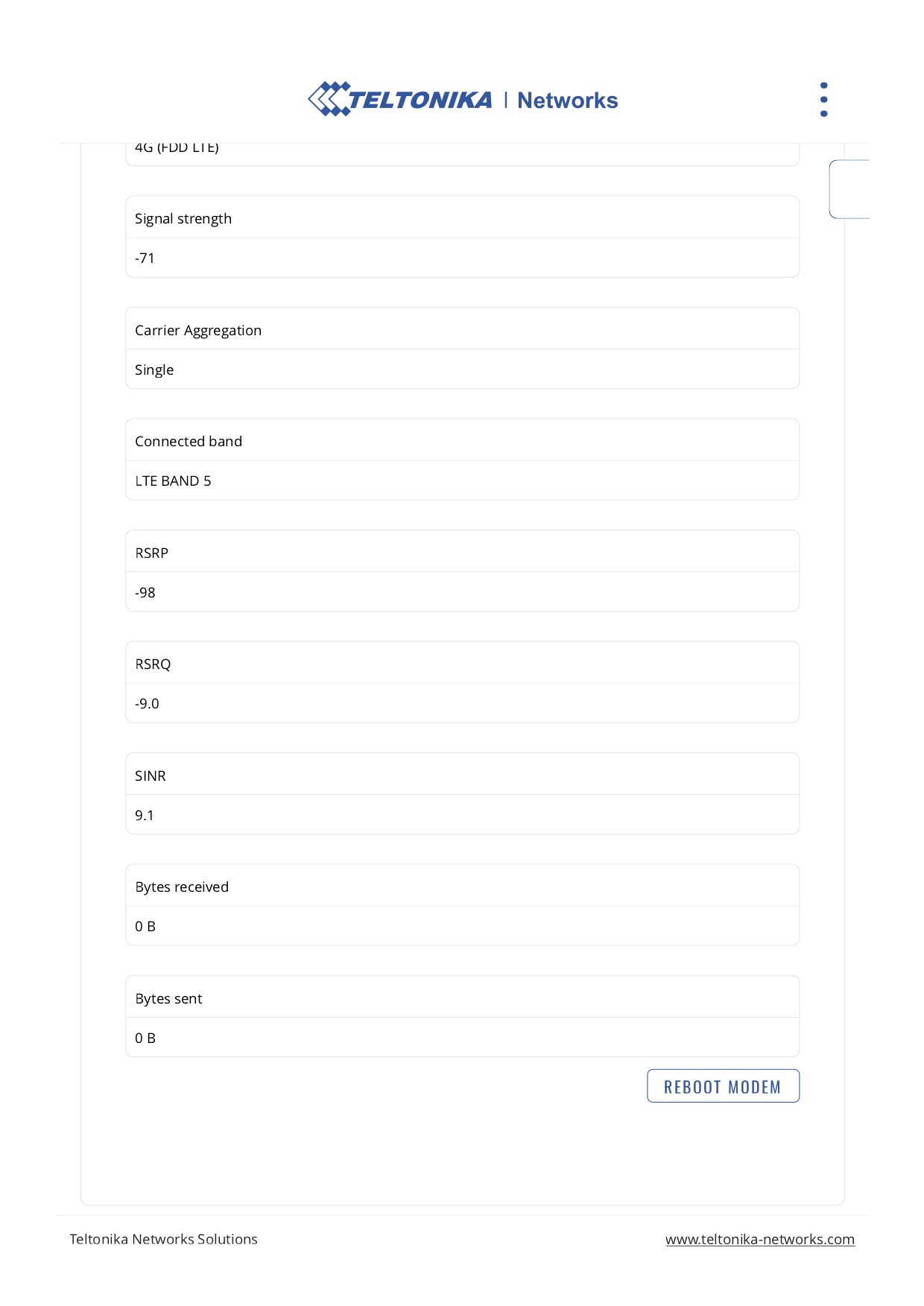

Just wondering if this cellular router works for 4G LTE SIM card in Hong Kong.
I have already tried two SIM cards, but in vain.
Please see attached file for details.

From the picture you’ve posted, it is quite obvious that the router struggling to connect to get a better connection. You could refer to this page to see how we interpret some parameters like RSRP, RSRQ, and SINR besides signal strength, to understand the mobile connectivity strength and quality :
Mobile Signal Strength Recommendations - Teltonika Networks Wiki (teltonika-networks.com)
so I suggest you test RUT950 in another location, and check whether it has a better signal. If not, you could also re-check the attached antennas and make sure both antennas (main and aux) are properly attached to the router.
If issues still persist, it would be great if you could replicate the issue you are currently having, then access router’s WebUI, go to SYSTEM > ADMINISTRATION > TROUBLESHOOT section, download troubleshoot file from there and send it to us.
Just, make sure that troubleshoot file is generated when the issue is present and before a reboot (So it can be seen in the logs).

[MODEM: “1-1” GSM INFORMATION]
connstate: Disconnected
netstate: searching
imei: xxxxxxxxxxxxxxx
model: EC25-AF(D)
manuf: Quectel
serial: 864839048453571
revision: EC25AFFDR07A09M4G
imsi: xxxxxxxxxxxxxxx
simstate: inserted
pinstate: READY
signal: -71
cellid: N/A
operator: N/A
opernum: N/A
conntype: FDD LTE
temp: 360
network: +QNWINFO: “FDD LTE”,“45406”,“LTE BAND 5”,2460
serving: +QENG: “servingcell”,“LIMSRV”,“LTE”,“FDD”,454,06,166EA47,172,2460,5,3,3,27E3,-96,-9,-69,14,25
neighbour: +QENG: “neighbourcell intra”,“LTE”,2460,172,-9,-96,-69,0,25,255,4,0,255
band: LTE BAND 5
software: EC25AFFDR07A09M4G

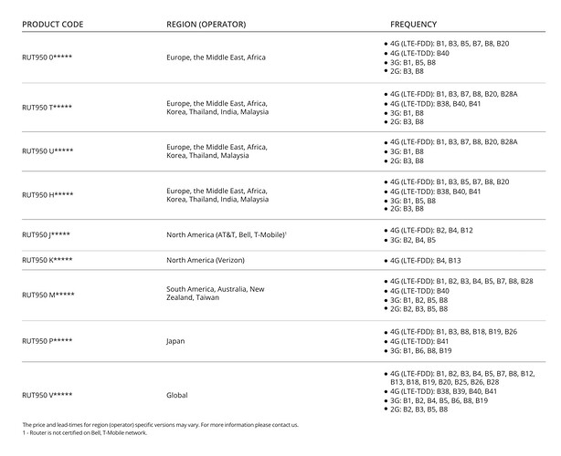

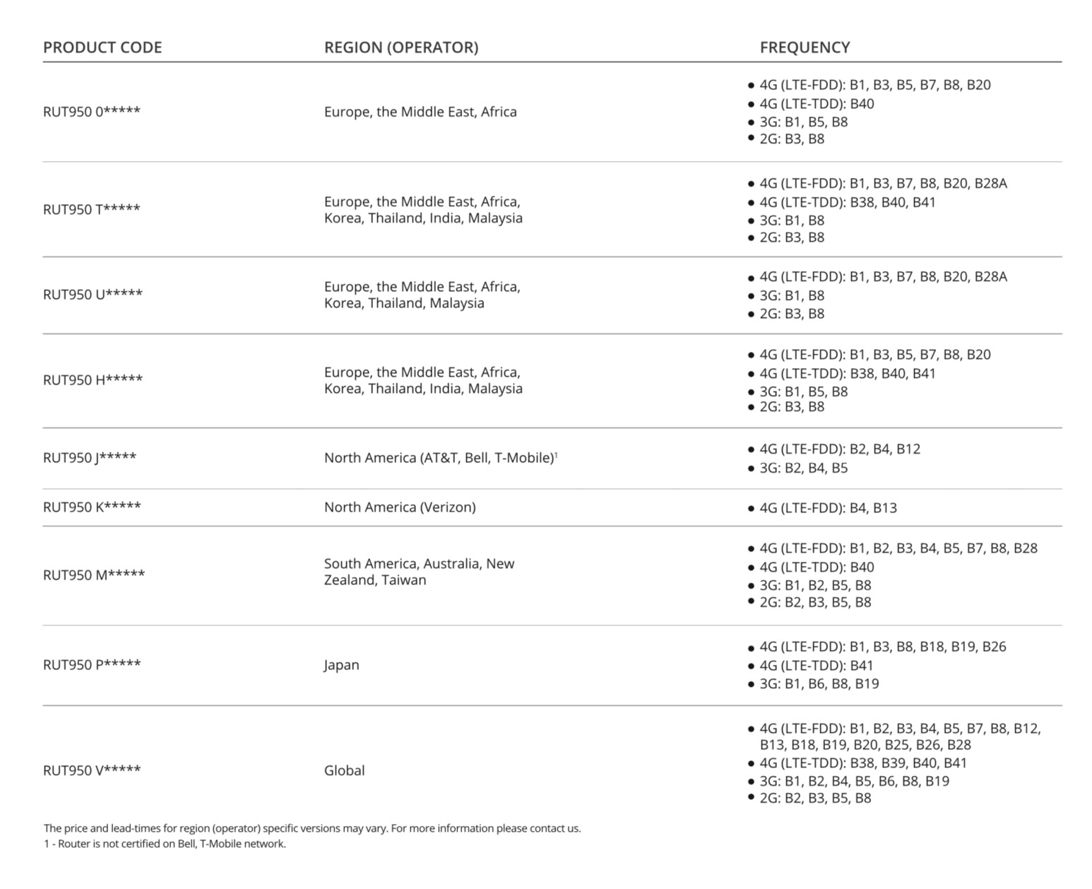

Additional info: Product Code: RUT950W02400
I cannot find RUT950W (available versions) from the following picture.
Upon reviewing the product code and the modem type it is used (Quectel EC25-AF), it appears that your RUT950 router is intended for use in North America, specifically designed to work with Verizon, AT&T, and T-Mobile providers. This is the main reason why you are unable to establish a connection through the mobile uplink.
I recommend contacting the seller from whom you purchased this unit and inquiring about the possibility of obtaining a replacement that is compatible with the providers in your region. By doing so, you should be able to get a router that will work with the mobile networks available in your area.
You could refer to our ordering page for RUT950 here: RUT950 - 4G LTE Wi-Fi Router.
We would like to recommend RUT950 with RUT950 V***** (global version) as this type will be suitable for your region. Please see the picture below:
Last but not least, when dealing with the import of devices into Hong Kong, it is common to require additional documentation. Therefore, I kindly suggest you reach out to Hong Kong customs and conduct some research to determine the specific information that would be necessary for the import process.
