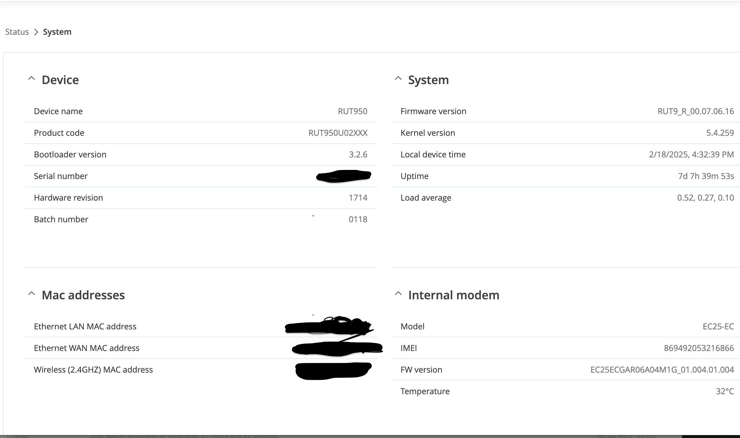

Could you please let me know the internal modem firmware version installed on your RUT950? You can check this in the System → Firmware → Update firmware page in the WebUI.

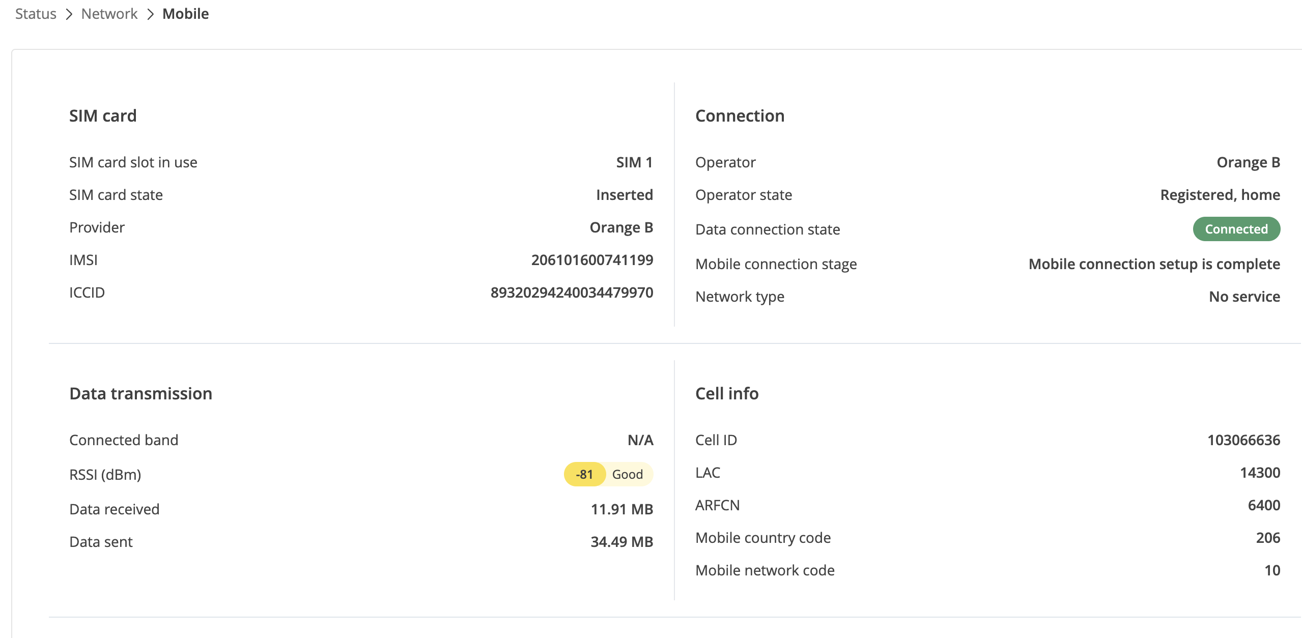

Additionally, please provide a screenshot from the Status → Network → Mobile page.

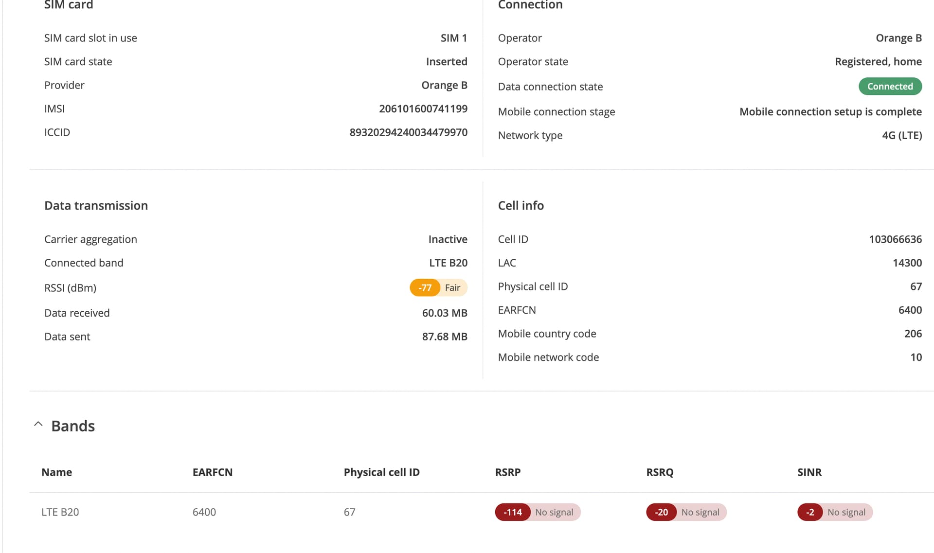

Could you please provide a full screenshot of Status → Network and logs in .txt format from System → Maintenance → Troubleshoot page System log → Show section. Make sure that sensitive information from logs (public IPs, MACs, etc.) is hidden.

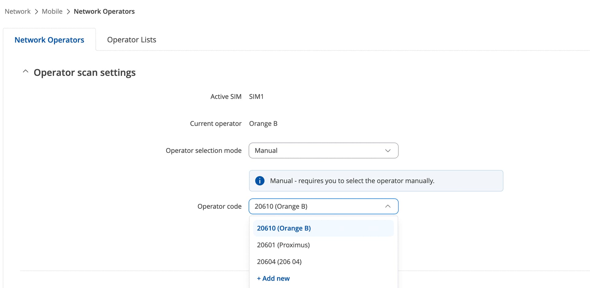

Additionally, could you try performing an operator network scan to check which operators are available at the moment? You can do this by navigating to Network → Mobile → Network operators (advanced WebUI mode required) and selecting Manual operator selection mode.
Lastly, which internal modem firmware version does your RUT950 have? This can be checked in Status → System page.

please let me know if if forgot to delete any other sensitive info.
Thank you for the update.
Based on the provided screenshots, the signal strength values (RSRP, RSRQ, SINR) indicate no signal or very poor quality, which explains the constant mobile connection dropouts.
I recommend checking the mobile signal strength recommendations here: Mobile Signal Strength Recommendations to optimize your setup.
