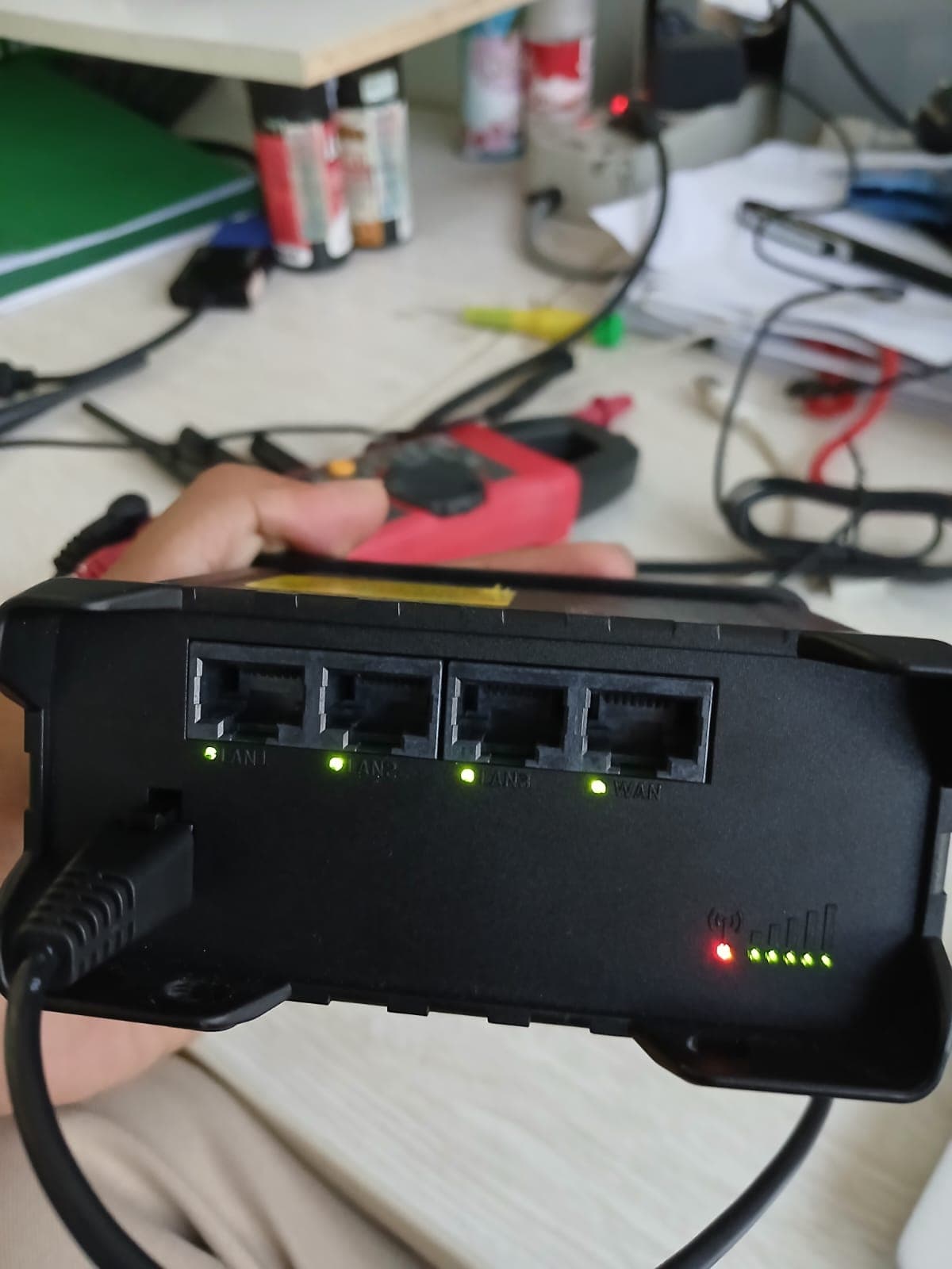

this is picture now condition device
The picture doesn’t really say much - are the LEDs flashing rapidly, or are they stationary? After doing the bootloader process, were you not redirected to the login page of the device after the process was finished? Could you explain the situation of the after-process?
Led stationary condition.
after doing the bootloader process there is no response or any situation. the condition is just like in the picture. all LAN LEDs and WAN LEDs are steady. Mobile network type LED is steady green and red.
Sounds like the device is stuck, if you haven’t already, could you try power cycling it by unplugging the power supply cable from the device and plugging it back in?
If the situation stays the same, could you possibly try the bootloader process one more time? If the situation doesn’t change after the repeated bootloader process, then I’m afraid there’s something from the hardware-side of things that is wrong with the device, and it will require repairs, for which you should probably reach out to the distributor/shop that you’ve purchased the device from.
