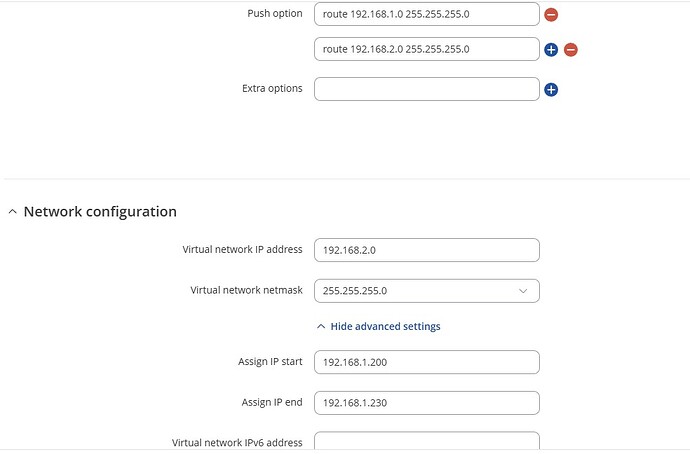

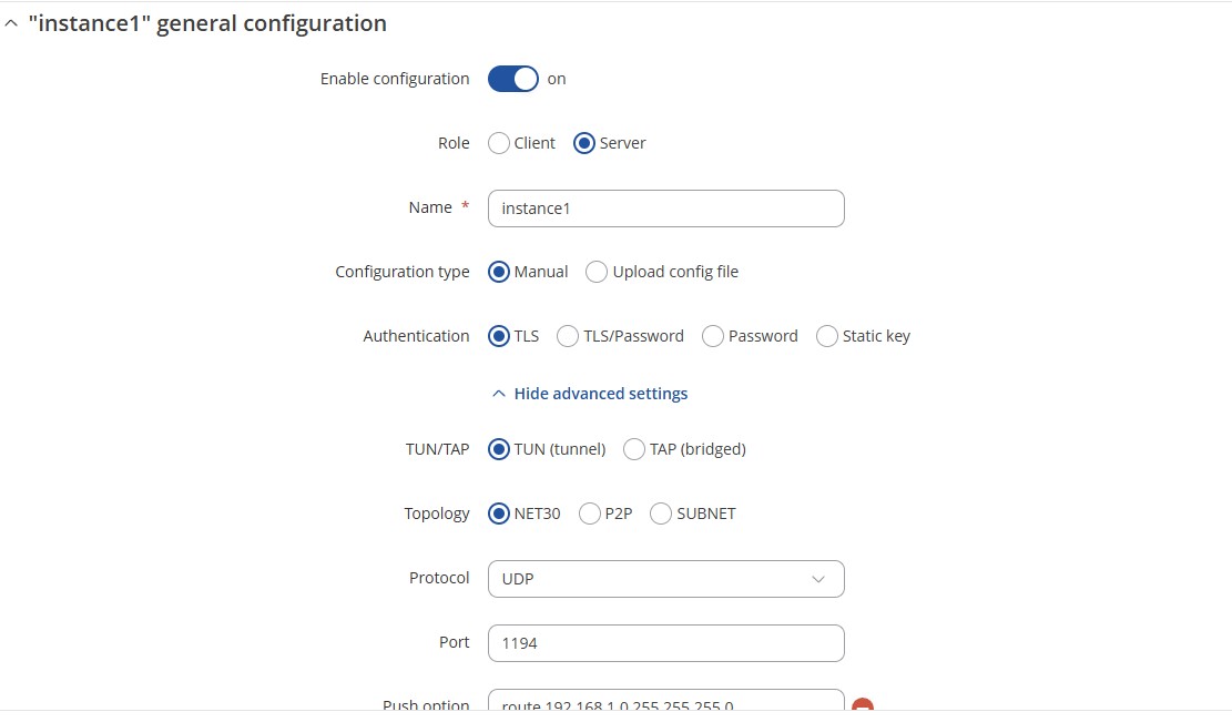

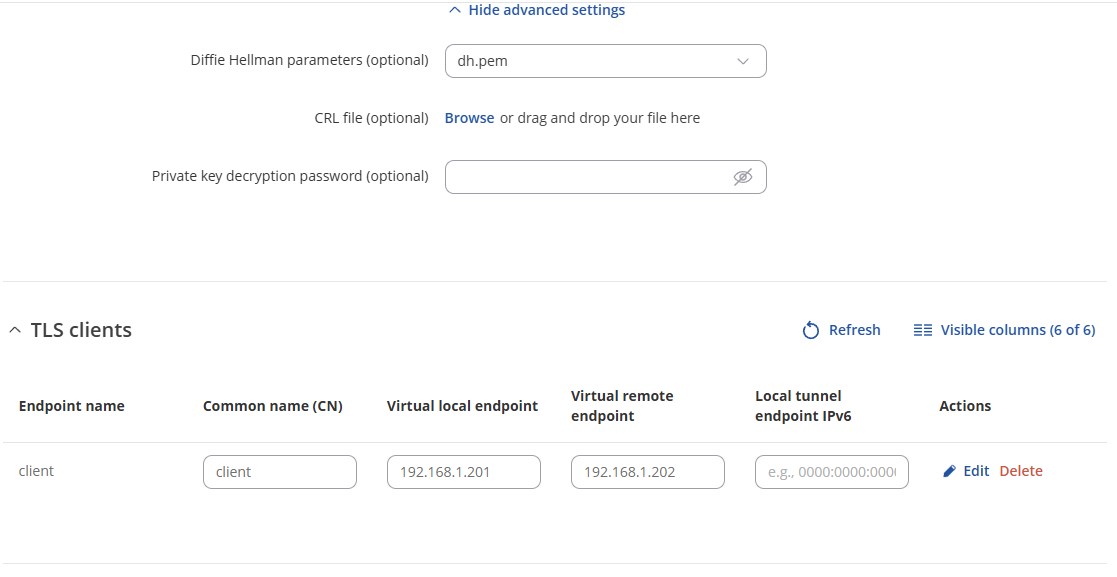

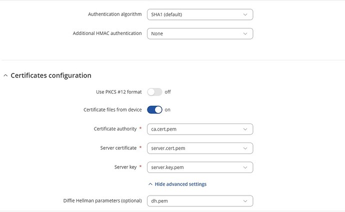

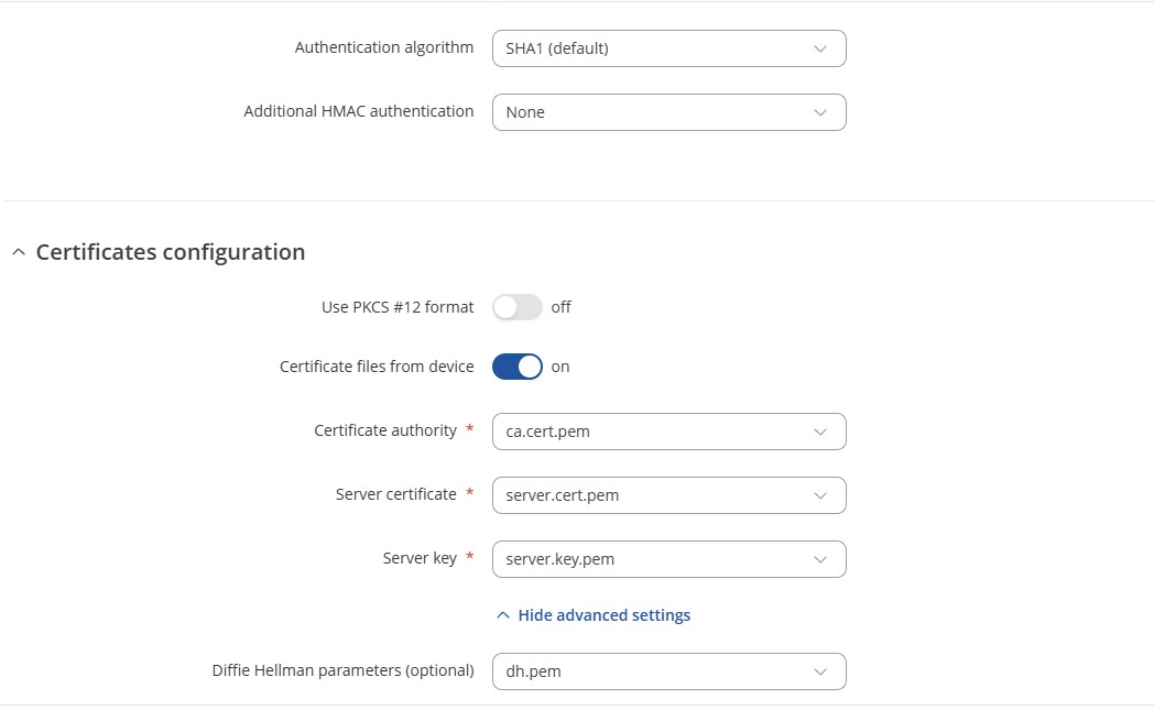

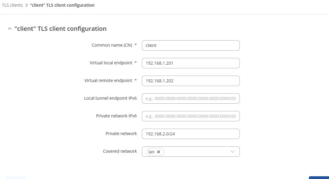

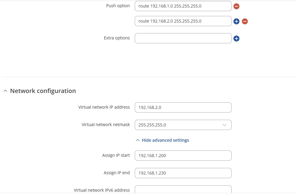

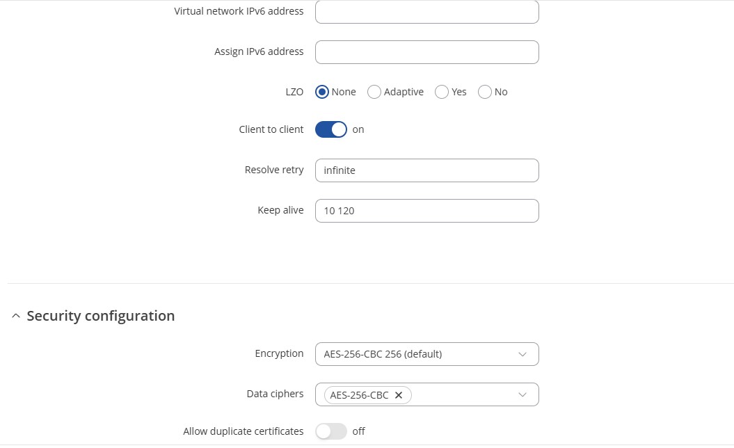

I want to connect to a device on LAN remotely through OpenVPN.
So I’ve configured OpenVPN Server on the RUT901 like this:
Then I’ve configured on my laptop OpenVPN GUI like this (The configuration was made on the RUT901, then exported):

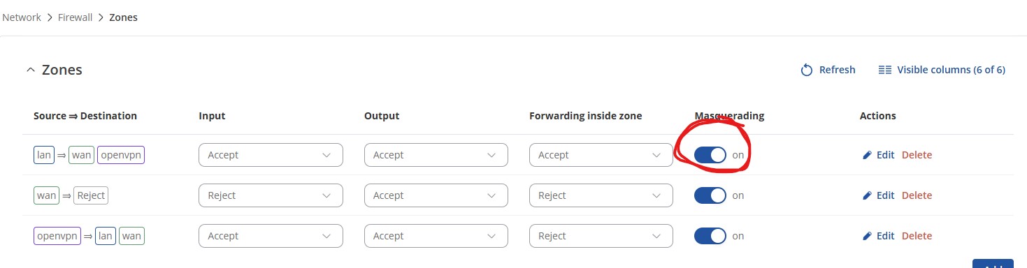

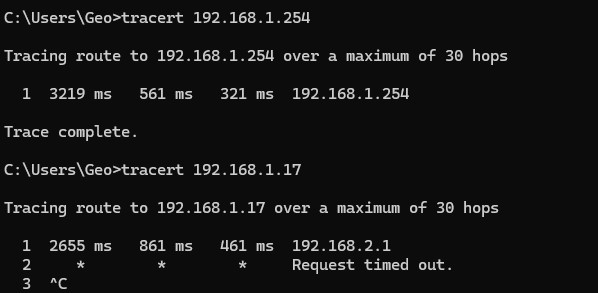

Now, the connection works, I can reach the router after connecting using the internal IP, but I cant reach the device on LAN1.
 found it, apparently I only had to switch to ON the Masquerading(that was default OFF) for one of the rules in the Firewall. An now it's working.
Thanks.
