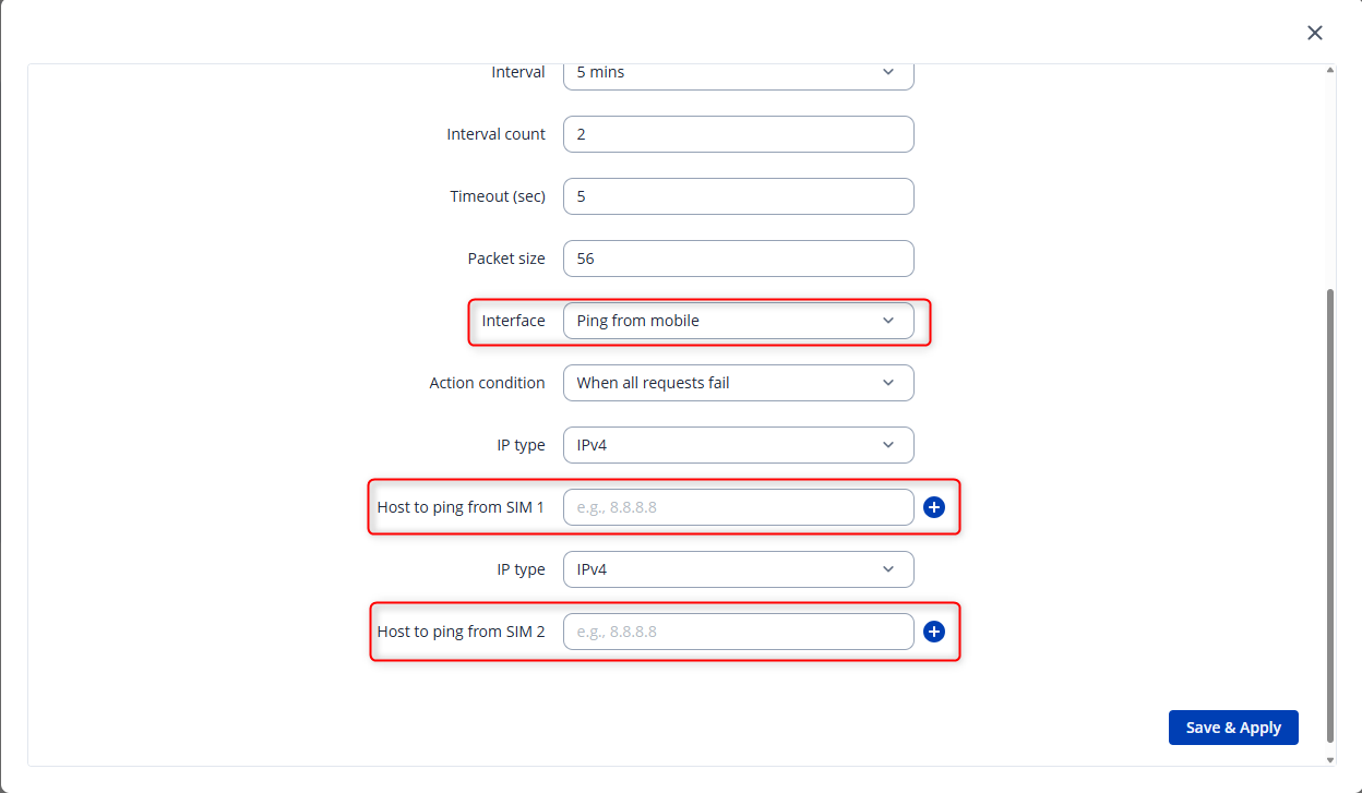

During the call we tried rebooting the device (physically), there is also an option called “Ping Reboot” it would allow to configure reboot every time the device is unable to ping to a certain host (e.g. 8.8.8.8 aka google). In your case, the interface should be selected as “Ping from mobile”, once this option is selected, you will be able to configure hosts to ping from SIM1 and SIM2, in case both of the pings fail, the device will automatically reboot. I attach a screenshot for more clarity.

Regarding the reboot issue, I posted a guide above on how to configure ping reboot, which essentially sends a ping to your selected host from both SIM cards. If both fail to receive a response, the device automatically reboots, removing the need for manual rebooting.
