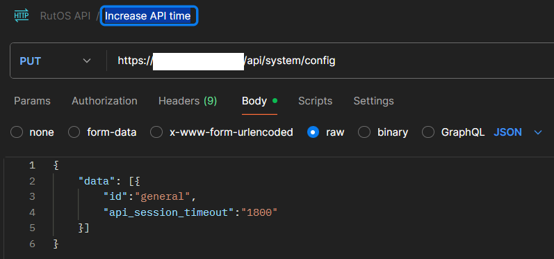

To extend the expiration time of an authorization token, you would need to follow these steps:
Login to the device to get a token.
Here you can find some more information about the authentication:
https://developers.teltonika-networks.com/fundamentals/#authentication
Send a PUT request like shown in the picture. The time in “api_session_timeout” is in seconds.
Please let me know if this helps you.
