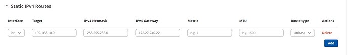

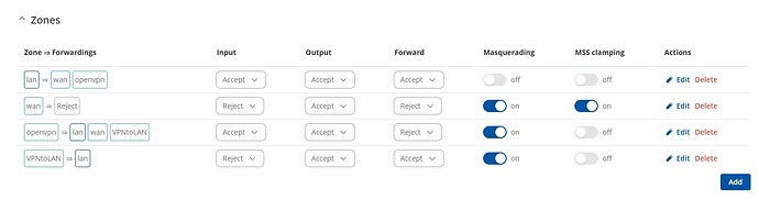

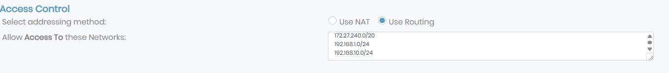

I am having trouble accessing the LAN network behind an OpenVPN client. My OpenVPN server is running on a VPS, and two clients are connected: a RUT901 router and a desktop computer.

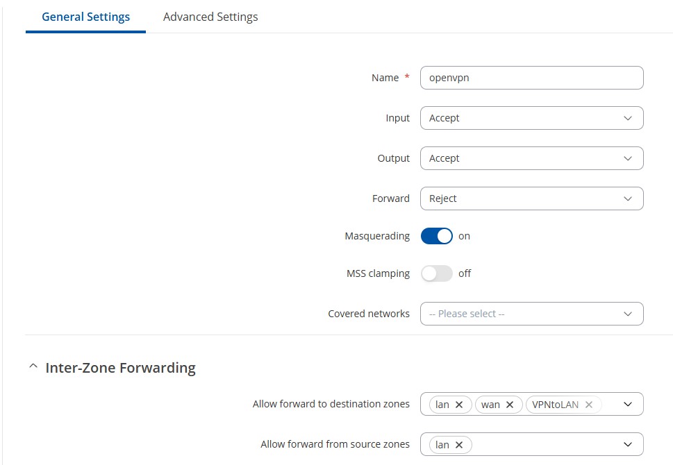

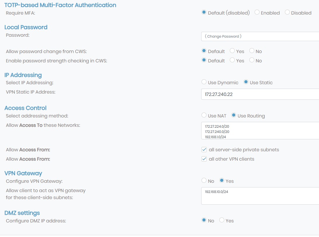

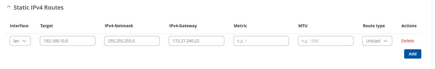

When I connect to the VPN from my desktop, I can reach the RUT901 (172.27.240.22), but I cannot ping a device in the LAN behind the router (192.168.10.10). After installing tcpdump, I can see ICMP traffic to 172.27.240.22 but not to 192.168.10.1 (the RUT901 LAN address).

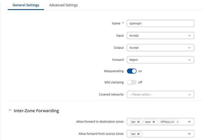

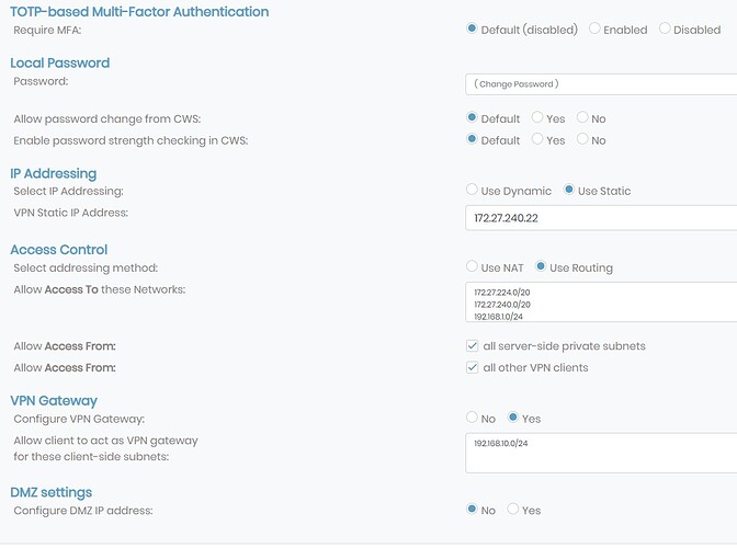

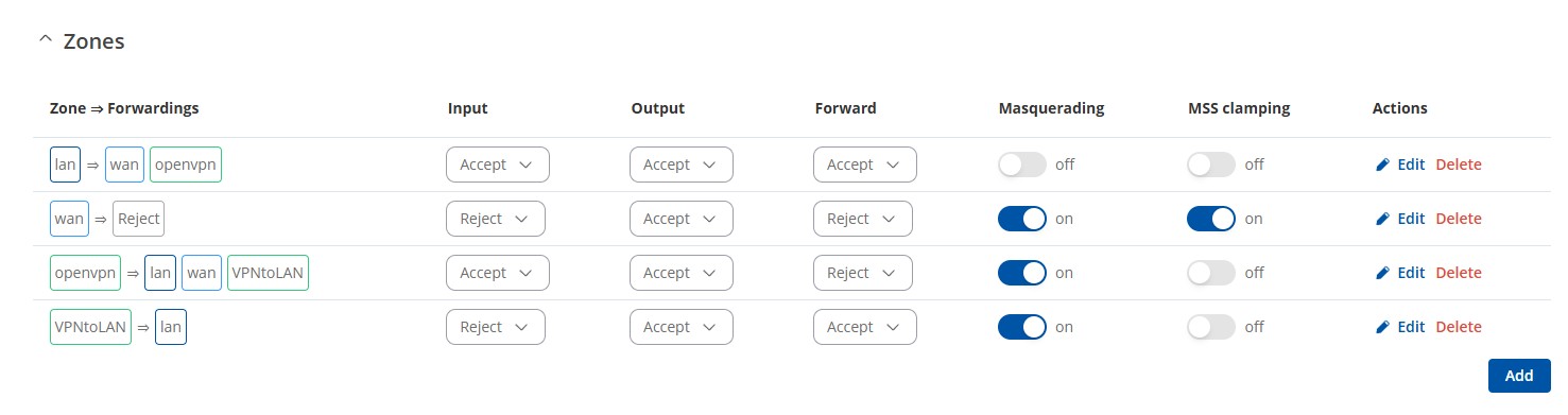

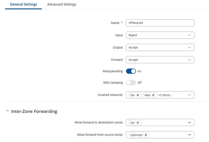

I have attached screenshots of my configuration.

Could you confirm whether the necessary route to the client’s 192.168.10.0/24 LAN network has been added in the OpenVPN server settings?
If the route is already in place, try enabling masquerading on the LAN zone (LAN → WAN, OpenVPN) to see if that makes any difference.

enabling masquerading on the LAN zone doesn’t make any difference.
