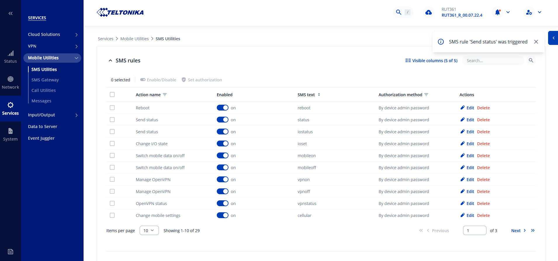

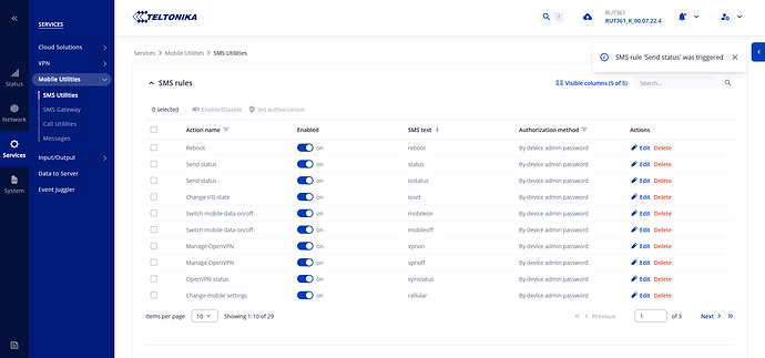

I updated both RUT361 units to firmware 7.22.4 and the issue persists unchanged.
The behavior is the same: after sending an SMS command, the WebUI shows the “SMS rule triggered” popup after approximately 2 minutes, but no SMS reply is ever sent back to the sender.
This feels like a bug specific to the RUT361 affecting outgoing SMS in the SMS Control reply flow. Is it known?

Bumping this post as I haven’t received any response in 7 days.
I purchased through Digi-Key and I don’t have access to the official support portal. Is there any way to open a support ticket in my situation? This forum is currently my only channel.
The issue is reproducible on two separate RUT361 units and is not present on the RUT200 with identical configuration.
