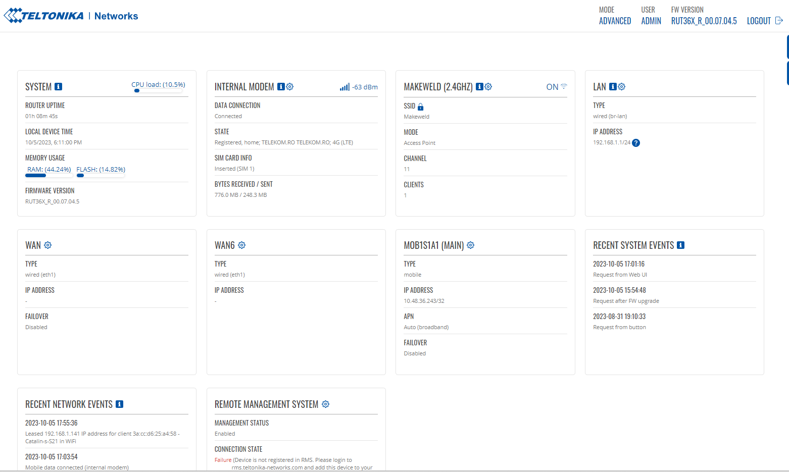

Below you can find some snapshots on config and gsm status… keep in mind that both routers are working in the same way… issue with download speed.

I will also ask you to attach a screenshot of the mobile status page (Status → Network → Mobile). Make sure to blur the IMSI, IMEI and ICCID values.
