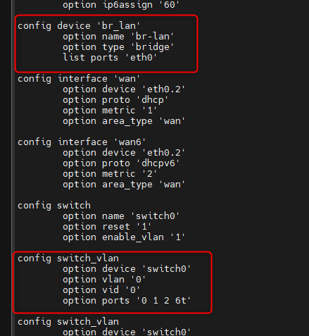

@Astropack Hello,
If the RUT300 worked with PROFINET and you are now experiencing issues with the RUT301, please try configuring VLAN 0 for the LAN interface. You can do this by following the steps below:
Access the RUT301 via CLI/SSH (username: root). If you need help with this, refer to the instructions here:
Edit network configuration file:
vi /etc/config/network
Use the arrow keys to navigate and press i to enter edit mode.
Modify the br-lan and switch_vlan sections as shown in the attached screenshot (attached for easier reference).
Save your changes by pressing ESC, then typing :wq and pressing Enter.
Ensure that the configuration changes are saved:
cat /etc/config/network
Restart network service:
/etc/init.d/network restart
Let me know how it goes!
Thank you very much, I made the changes in the configuration file as you wrote, and now the communication works perfectly!
