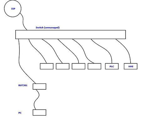

Hello, I got RUT301 router and I need to use RMS service to connect to HMI. How do I need to set up this router for a WAN bridge mode configuration to be able to reach HMI?
I need to be able to use RMS service to do some changes to the HMI from time to time. Also added example of topology.
Could you please clarify your setup a bit more and, if possible, provide the relevant IP addresses? As I understand it at this stage, your HMI is located on the RUT301’s WAN side, and you’d like to reach it using RMS Remote Connect?
If that’s the intended setup, then typically it should be enough to add a static route to the HMI via the RUT301’s WAN IP.
However, it would be helpful if you could provide any of the additional details, such as the topology’s IP addresses, the port/protocol used for remote HMI access, etc.
