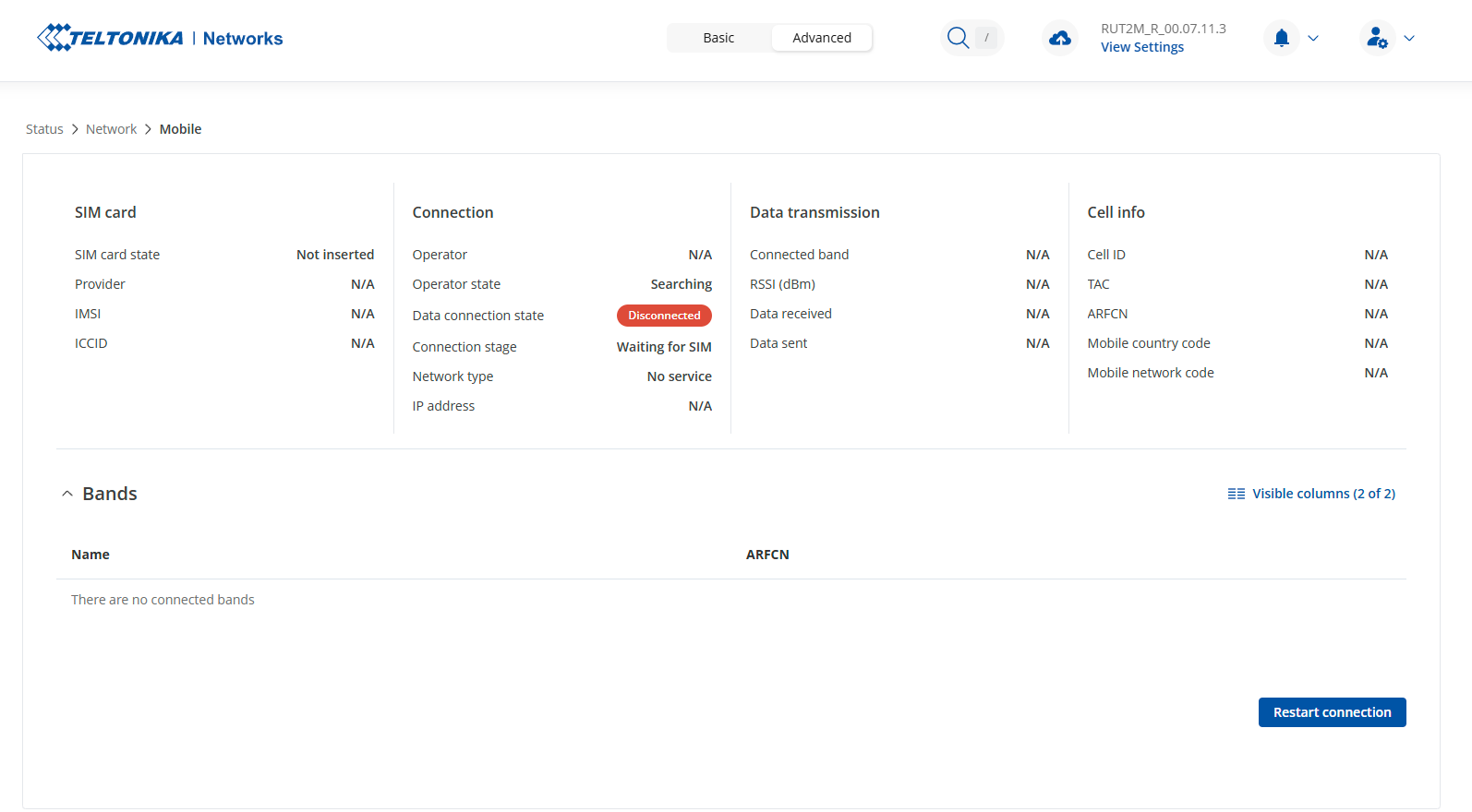

I have a brand new RUT260, but the inserted Nano Sim is not recognized.

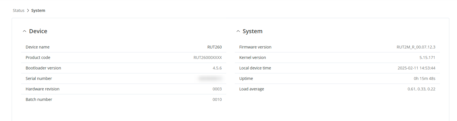

I upgraded the firmware and put one layer of electrical isulation tape on the backside of the nano sim adapter. The issue still exists and the two 3G/4G LEDs are still blinking every second
