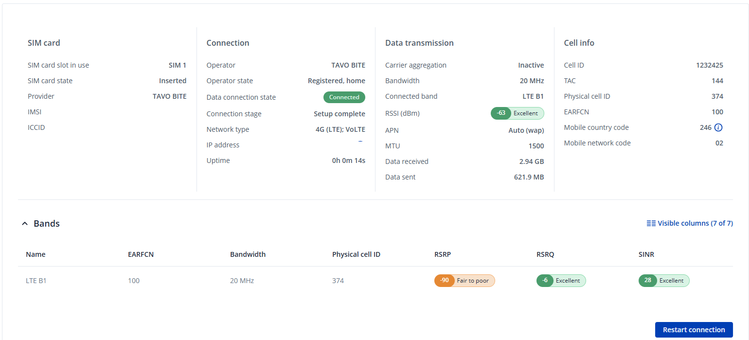

If it’s using Mobile WAN, please share screenshots of the Status → Network → Mobile page in the WebUI — both when the internet is connected and when it disconnects.

Yes, all my trials have been using Mobile WAN. In the status-network-mobile you could see that it got connected, ip address, time connected start increasing…. and counting about 10 seconds it got disconnected again.

Could you please provide screenshots of the Status → Network → Mobile page in the WebUI, both when the internet is connected and when it disconnects?
The sequence is the following one:
It is disconnected at the beginning
It says connected: (at status-network mobile, box named “Connection”, between SIM card and Data transmission boxes)
  • Correct Operator
  • Operator state is “Registered, home”
  • Data connection state in green “Connected
  • Connection state “Setup complete”
  • Network type “4G(LTE); VoLTE”
  • IP address: After 1-2 seconds, it appears an IP address
  • Uptime: Starts counting from 0s
More or less when it gets to 10 seconds the “uptime”, it gets disconnected and starts over again

I’ll also need screenshots to check the mobile signal strength so we can continue troubleshooting the issue.
For example:
