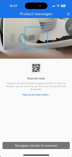

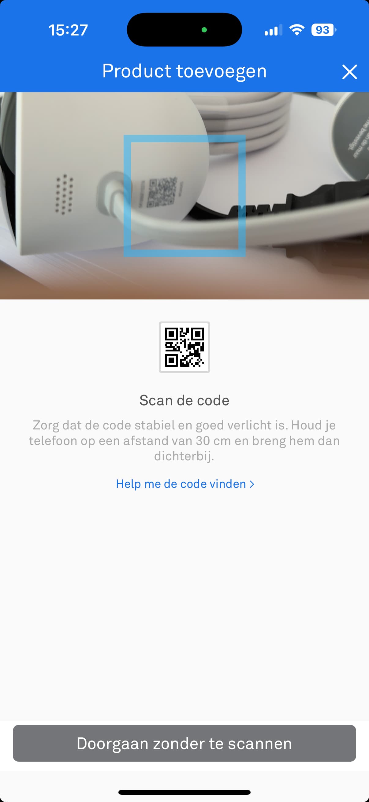

The connection to the cam is made through the Nest-app. After scanning the QR code, it makes connection via bluetooth and starts the process tot connect to wifi.
The wifi connection itself works with an iPad if phone. But the Nest-app says C106, number connection possible.
Herewith some screenshots of the configuration.
