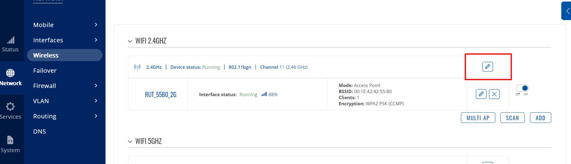

Can you check first if the WiFi SSID is showing on your available WiFi networks? Since you need to connect a device to the access point first for it to display the signal strength in the WebUI.

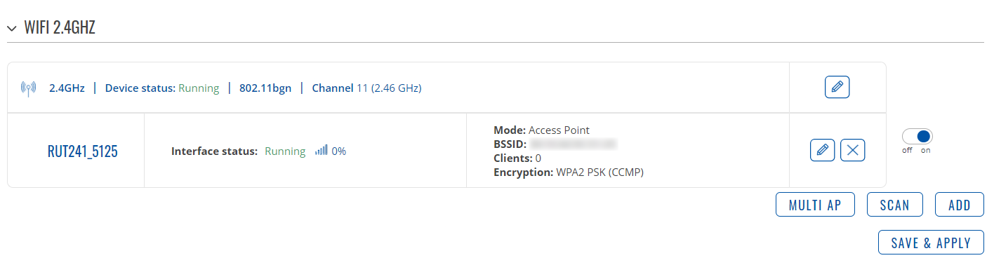

As you see below, I have a RUT241 where it has the same output as yours

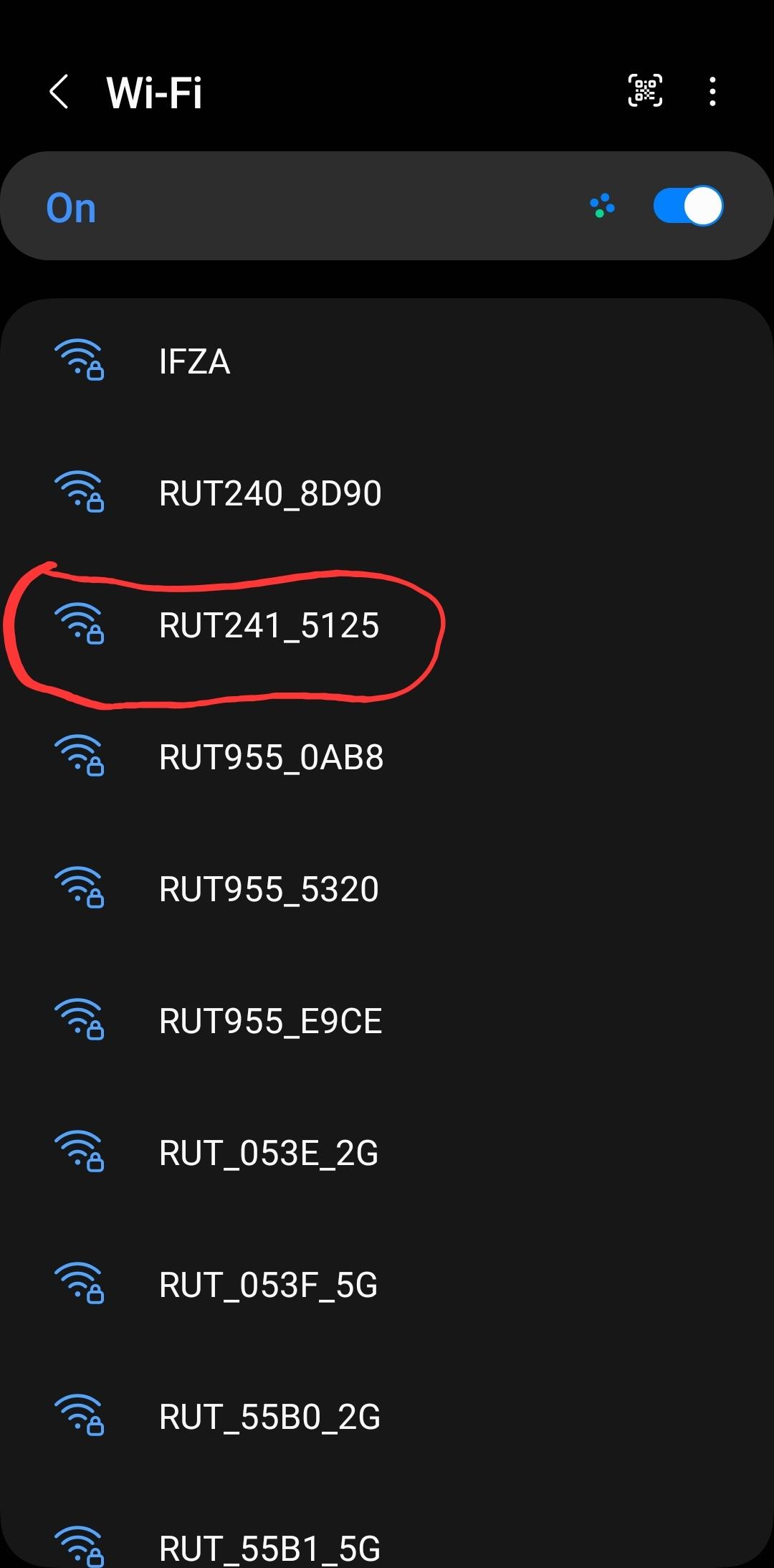

But it still showing on the available Wifi networks on my phone

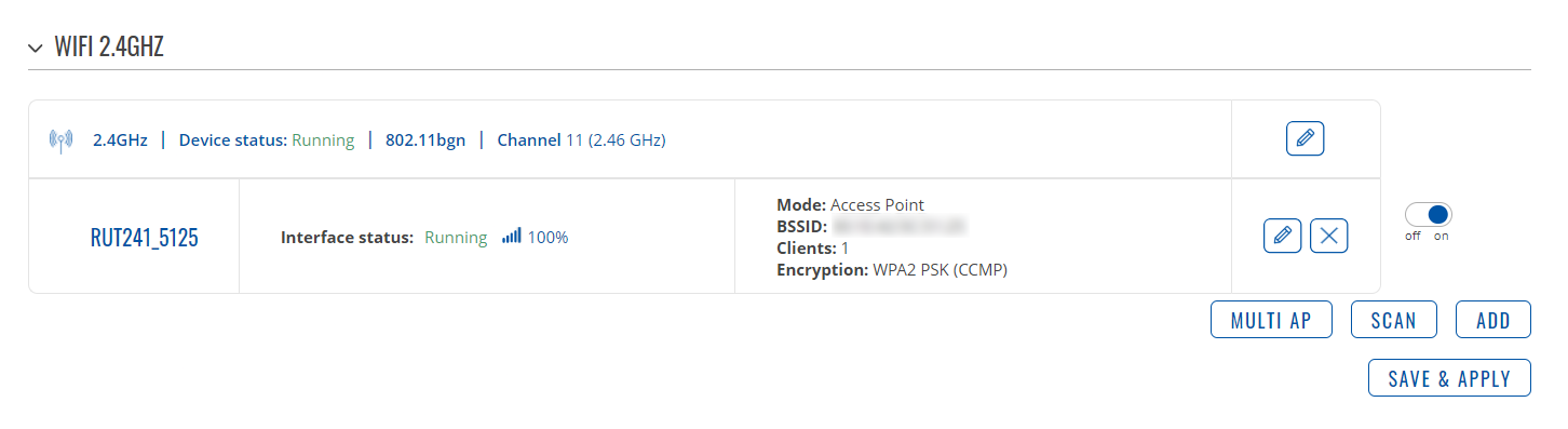

After connecting to that Access point, it now displays the signal strenght of the access point and is working fine.

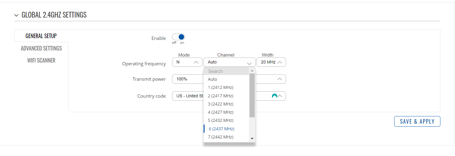

One factor that’s causing your issue is the WiFi noises in the area itself. You can download a WiFi analyzer mobile app to check the channel from different wireless networks. From there, you can adjust and lock the channel for the WiFi AP of your RUT241.
