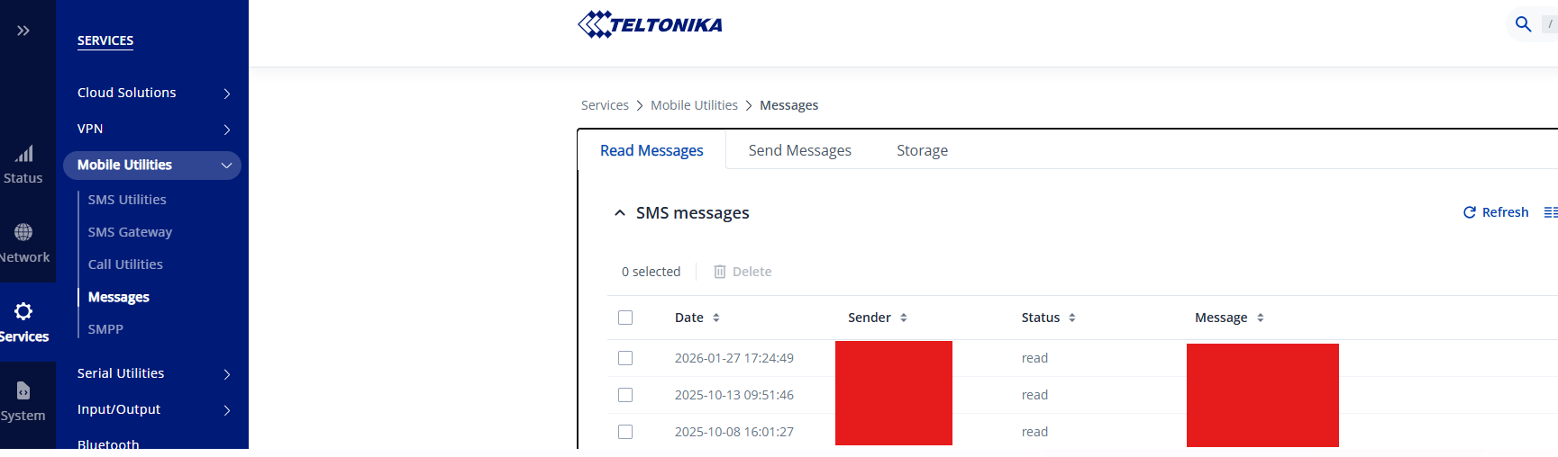

Next, please navigate to Services → Mobile Utilities → Messages and check whether the SMS messages sent to the SIM card are visible there.

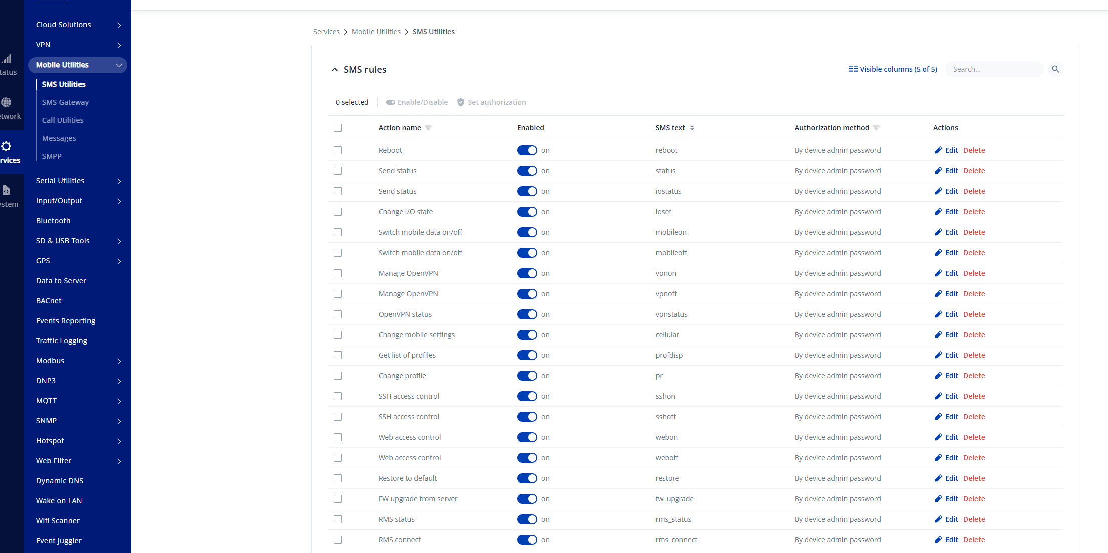

If you can see the received messages, go to Services → Mobile Utilities → SMS Utilities and verify that the relevant SMS rules are enabled (they are enabled by default).

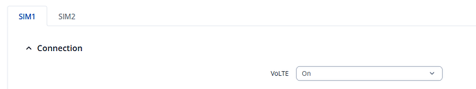

You may also try enabling VoLTE to see if it resolves the issue. To do this, navigate to Network → Mobile → Connection and set VoLTE to On .
