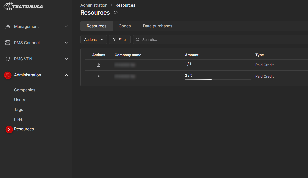

  • Do you still have required resources (credits / management packs)? You can always check how much resources have left by following the steps in the screenshots:
For more detailed information about your current resources:
The resources should be visible in the area that is marked red:

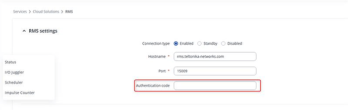

  • If there is a triangle with an exclamation mark right next to your device, please clarify the error message you see once you hover your mouse above it. If it says that the authentication code is needed, and in case you missed the authentication code during device registration, you can view it in the Device’s details page in RMS or by changing table settings in the Devices page to display the Authentication code column. If the code was not presented, ignore this step.
For more information, you can visit this article:

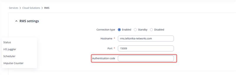

If the code was presented, it should be entered in the router’s RMS settings: Services → Cloud Solutions → RMS. Enter the code in the field highlighted in red in the screenshot below:
  • Once the code is added you can try to re-establish connection to the RMS server simply by pressing reconnect button on the right hand side of the screen.

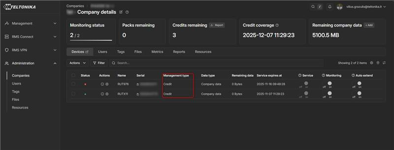

  • Was any of the resources used on the device that you’re trying to add to RMS?
You can check if the resources were added to your device by going to Administration → Companies, then select your company and press on View company details button. Then you should see a similar window:
In the area marked in red, you should be able to see whether any resources were used and, if so, what kind they were.

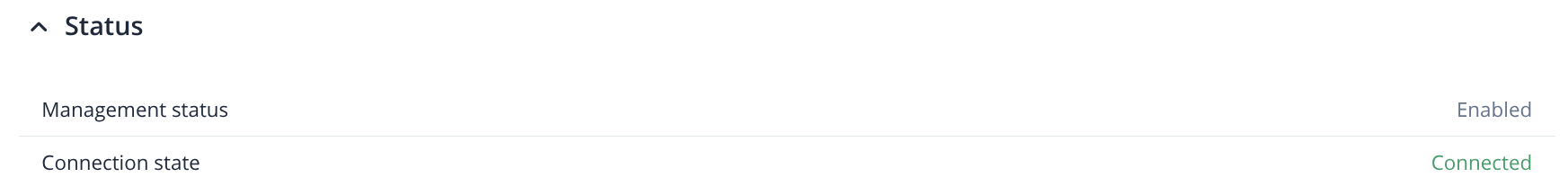

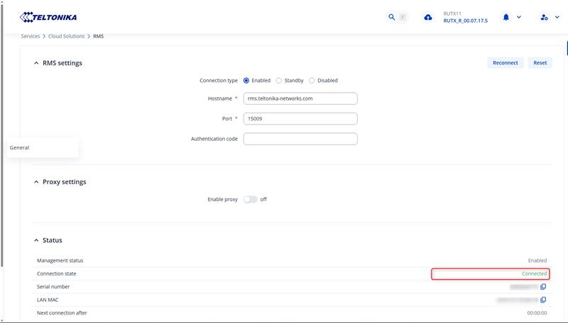

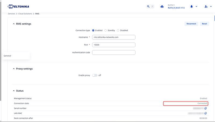

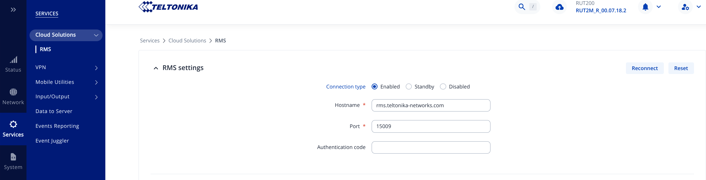

  • Additionally, if you have access to the device’s WebUI, could you please clarify the RMS status? You can find it in Services → Cloud Solutions → RMS. It should look similar to this screenshot:
When the device is offline, you should be able to see an error message in the area that is marked red.
