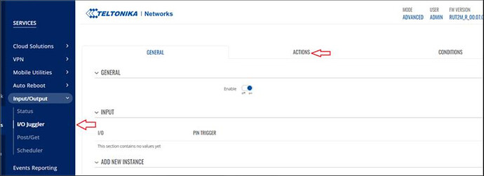

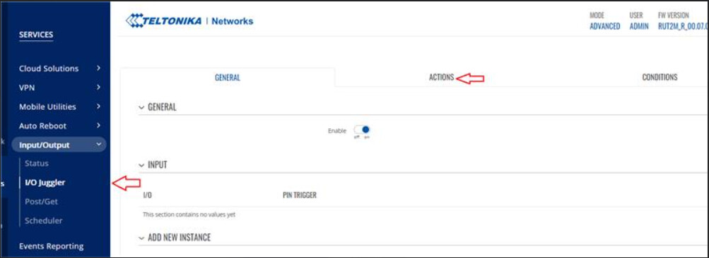

Regarding your second requirement, RUT241 does have a feature called I/O Juggler, this feature provides the possibility to create automated rules that perform certain actions based on Input state changes and other conditions. The operating sequence of the I/O Juggler can be visualized as such.
I/O juggler does not have a call option action, only SMS option is present.
To configure this navigate to Service→ Input/Output →I/O Juggler.
For more information please visit RUT241 Input/Output - Teltonika Networks Wiki
When an Input Trigger occurs, the Input check to see if user-specified conditions are also met. If so, it executes a user-specified action.

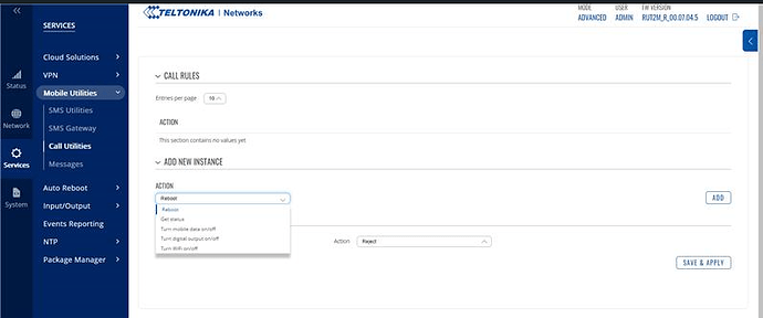

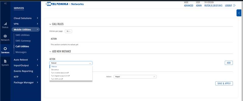

Just like SMS Utilities, Call Utilities provide you with the possibility to issue certain commands to the router from your mobile phone. The list of possible rules is of course shorter because you can only make one type of call. Keep that in mind when creating Call utility rules because one call will trigger all of the enabled rules at once.
To configure navigate to Service→ Mobile Utilities→ Call Utilities
This option specifies the action to be performed on incoming calls. Call utility rules will keep getting executed while the call is active.
For more information on mobile utilities please visit RUT241 Mobile Utilities - Teltonika Networks Wiki
On your third requirement of at least three inputs, unfortunately, RUT241 has only 1 input located on the Power socket.
for more inputs/outputs we have device called RUT955 & RUT956 which contains 6 I/O’s & 8 I/O’s respectively.
