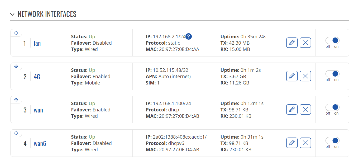

When you connect RUT241 to the other router via ethernet cable, could you please access RUT241, navigate to Network → Interfaces, and check the IP addresses on both, the LAN and WAN interfaces? If both of those start with 192.168.1.x, then edit the LAN interface and change the IP address to some other adddress. For example, 192.168.10.1 (make sure the IP address on LAN starts with 192.168.x.x).
Hello, I have configured the settings as suggested. But still no internet via the wan port. I have uploaded some images, it shows all interfaces online. When viewing the failover page the status for the wan shows offline still.
Any other suggestions to fix this? I thought this would be plug and play.

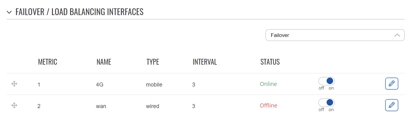

One more image.
You have failover configured with mobile connection as the main one. Could you try removing the SIM card from the router (simulate failure) and see if you have internet connection over the wired WAN?
Thank you all for responses, I have got it working.
I left all wired connections in place and SIM card, I then restored back to factory default and started again.
Everything worked immediately.
