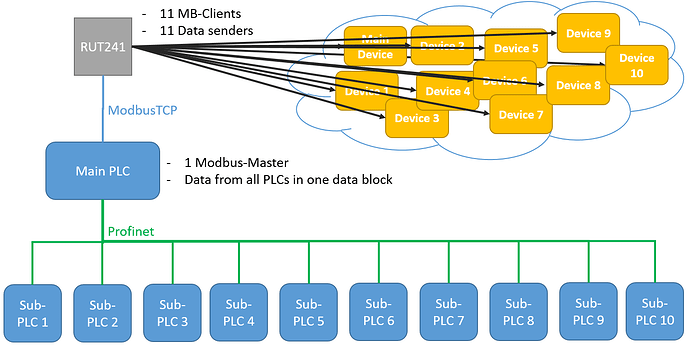

I drew a picture of the architecture, I hope it is clearer now.
We have only 1 Modbus Master in the main PLC.
All other PLCs do not communicate by ModbusTCP but ProfiNet.
We don´t use several Modbus Masters because that would consume too much RAM in the PLC.
So one Master, one Data Block.
In this Data Block is all the data from all PLCs.
But we need one device for every PLC in the cloud.
So me made 11 Modbus Clients so we can make 11 data senders.
Each data sender can send the data from one PLC to one device in the cloud.
Otherwise it would be too much work to separate the data in the cloud.

Also, if I understood your setup correctly, you have 11 Modbus TCP clients configured with the same IP (the main PLC), each acting as a data sender for a different PLC’s data block. Out of curiosity, is there a particular reason why you can’t configure a single Modbus client instance with multiple requests (each targeting the different register ranges for each PLC’s data within the central data block on the main PLC)?
We tried it with 7.14, but not with 7.15.
We will do this and report back.
The PLC data block is always the same, just different bytes are addressed.
The reason is that we need different data senders to address different devices in Thingsboard. If every data sender would use the same modbus client, they would all have the same data in the message.
