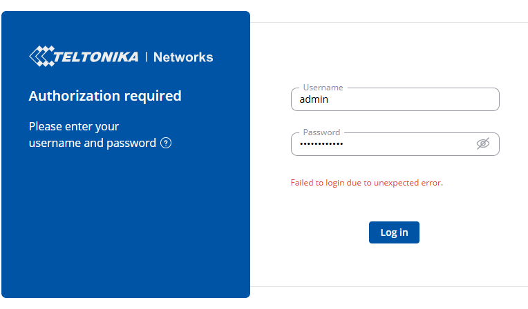

RUT241 "Failed to login due to unexpected error"
Hi
Today I got an error message when in the WebUI when trying to login to RUT241 “Failed to login due to unexpected error”, it is not wrong password, and it is only possible to login to SSH.
Power off/on or Reboot does not solve the issue.
From CLI command: logread -f
1480 Sun Feb 9 11:27:04 2025 kern.notice User “admin” successfully authenticated on HTTP from 192.168.2.186 to 192.168.2.1
1481 Sun Feb 9 11:27:04 2025 daemon.err uhttpd[1928]: vuci: accepted login for admin from 192.168.2.186
Please advice.
BR
Peter
