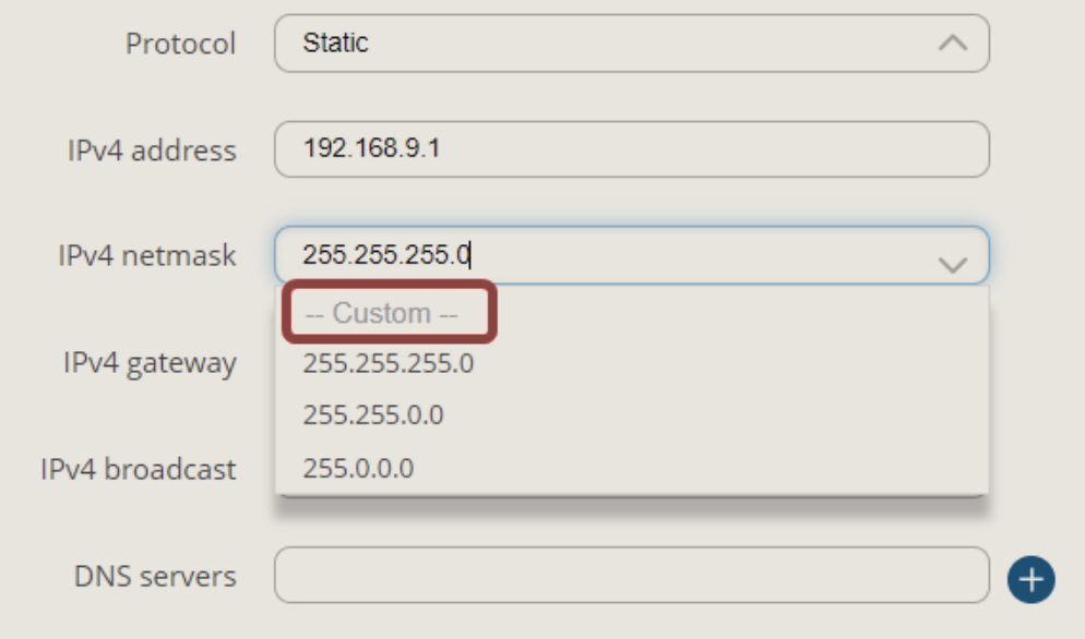

RUT241: Custom netmask fails
I am trying to set a custom netmask 255.255.252.0.
But the RUT 241 (RUT2M_R_00.07.04.5) does not use it. The UI switchs back to 255.255.255.0, Any ideas how to solve it?
Make sure you enter the netmask into the -- Custom -- field (click on the custom in the dropdown menu):
