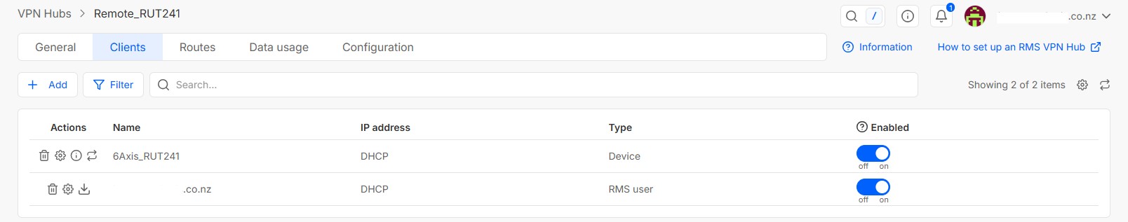

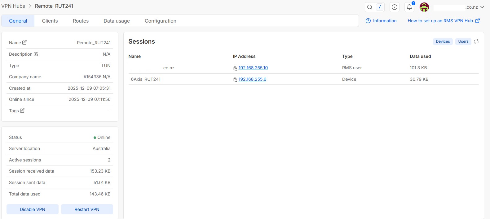

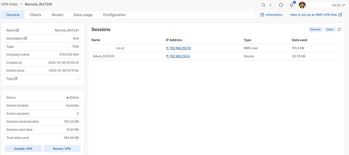

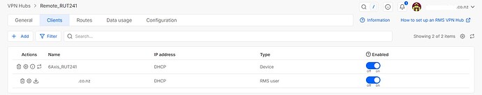

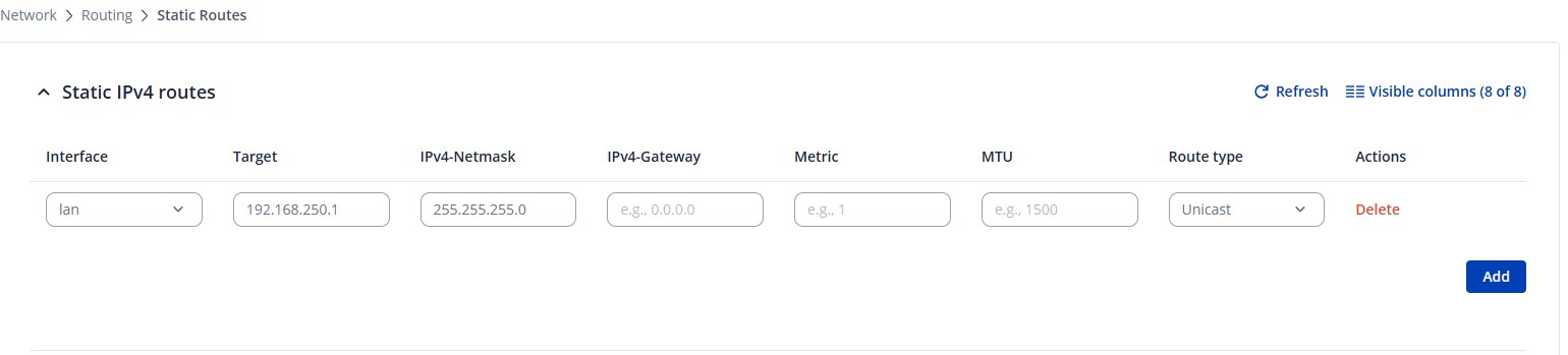

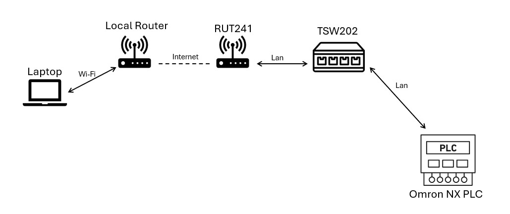

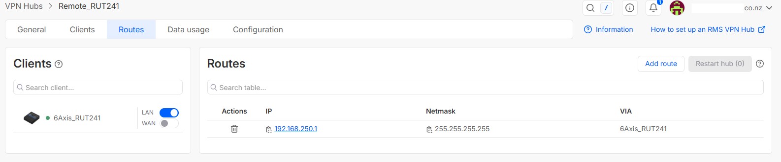

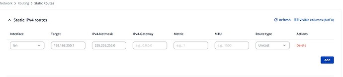

Using the RMS VPN Hub setting are below. Trying connect to a device 192.168.250.1.
Basic Topology

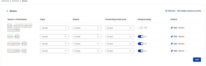

From the screenshots, it appears that two RMS → LAN firewall zones are present, which can create routing or NAT conflicts. To narrow down the issue, could you confirm whether an additional OpenVPN configuration is active on the device? If so, please temporarily disable it and try accessing the device again to see whether the behavior changes.
Additionally, it may help to ensure that masquerading is enabled on the WAN/RMS-facing zone, as this can prevent address translation issues when the device communicates with RMS.
Please let me know the results after testing, and I’ll be happy to assist further.
Warm regards,
Thank you Vilius. That did the trick not sure where the second RMS-Lan came from. Anyways deleted both and resent to RUT241
