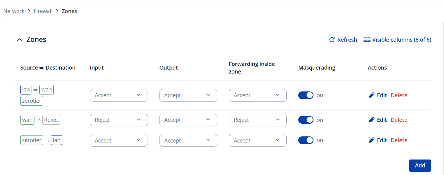

Trying to connect router with ZeroTier VPN to control the router remotely. But after done the setting the router still not connecting with the VPN. Now case is when using the Router’s WiFi is able to ping the ZT’s managed address but when using the other internet which connected the ZT couldn’t ping back to router.
For troubleshooting purposes, we will require more sensitive information from your end, such as the troubleshoot file, which may contain passwords, public IP addresses, serial numbers, and such. To avoid leaking this information, we have sent you a form to fill out, which you will receive in your e-mail inbox that you have registered your account with in the forums. In the *Ticket ID* field of the form, please enter the ID of this thread, which is *17328*.
Summary of the remote session: the issue was resolved after updating the VPN client(PC) configuration and re-adding the routes on the VPN server.
