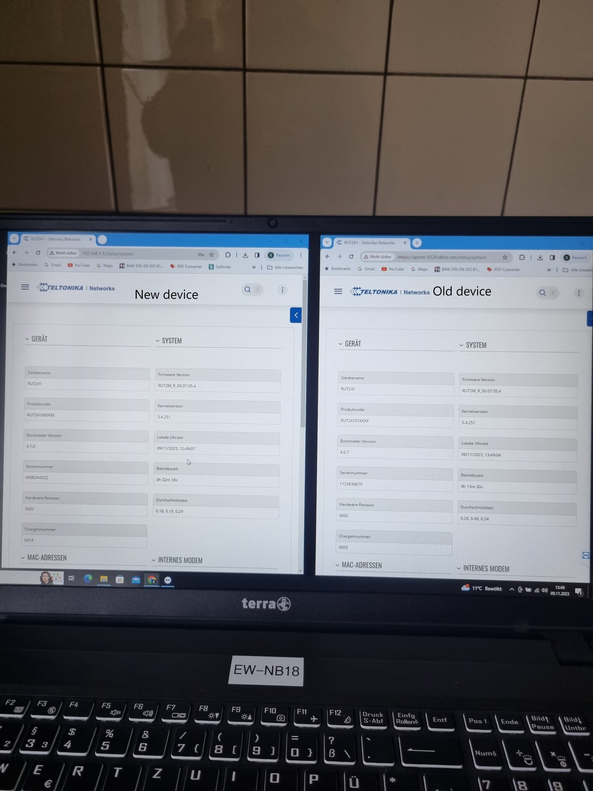

I have followed the instructions provided by Teltonika, I updated the firmware on the installed router, so that it matches the new one, I have created a back up file from the installed one and when I try to upload it into the new router I receive an error message, saying INVALID BACKUP.
Check for yourself. The two devices are almost identical, but it does not seem to work.

Hi, someone please correct me if I’m wrong, but if I recall correctly it’s because the product code is different:
  • Old device is RUT24101XXXX
  • New device is RUT24100XXXX
There’s a relevant statement on the wiki page:
“…after you create a new backup file, you can use it to restore the configuration of the current device or upload it to other identical devices…”
https://wiki.teltonika-networks.com/view/Configuration_Backup_RutOS

As @invalid_route has mentioned, these devices have different LTE modules and thus, backup files from one device cannot be uploaded to the other.
You could try UCI import/export to copy configurations. On Windows machine, WinSCP application can be used to download/upload files onto the router. Though there can be issues because the devices are different.
