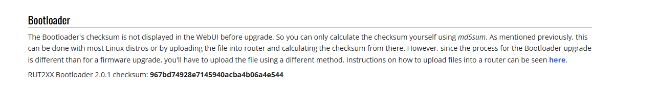

Our RnD departament have checked the U-Boot checksum is correct. You are using U-Boot version 4.3.0, which can be confirmed by logging into the device’s WebUI and navigating to Status → System.
Your bootloader is the same as when the device was first manufactured. The Md5 hash is correct.
From your description, it seems you are comparing the U-Boot checksum from your RUT241 device with an older version (2.0.1) found on a wiki page for RUT230/RUT240 devices, and are concerned about the mismatch.
