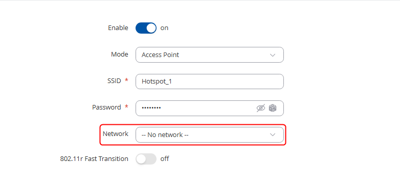

Could you clarify your current setup? How is your hotspot network created? Do you have a second LAN interface configured for the hotspot?
By default, when creating a Hotspot, it has its own DHCP server, so you don’t need to configure it manually. Additionally, when creating a SSID for hotspot network you don’t need to assign a network to it:
If you need further assistance, feel free to reach out.
Martynas,
Thanks for guiding me to the solution. It was not necessary to assign a network to the connection.
