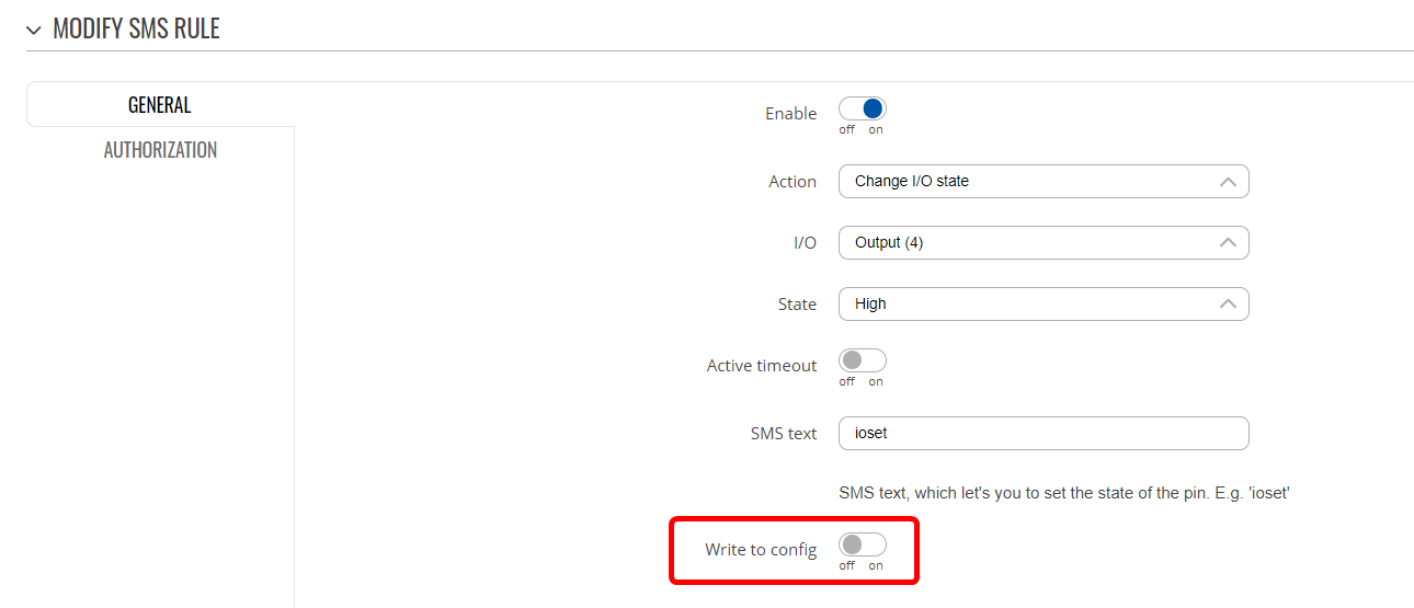

It is possible, although it will require some modifications to the existing rule.
Navigate to Services → Mobile Utilities → SMS Utilities. Edit the ioset rule, and enable the checkbox “Write to Config”. This option will write the current state of the relay to the flash memory and when the device reboots it will stay in the same state as before the reboot:
