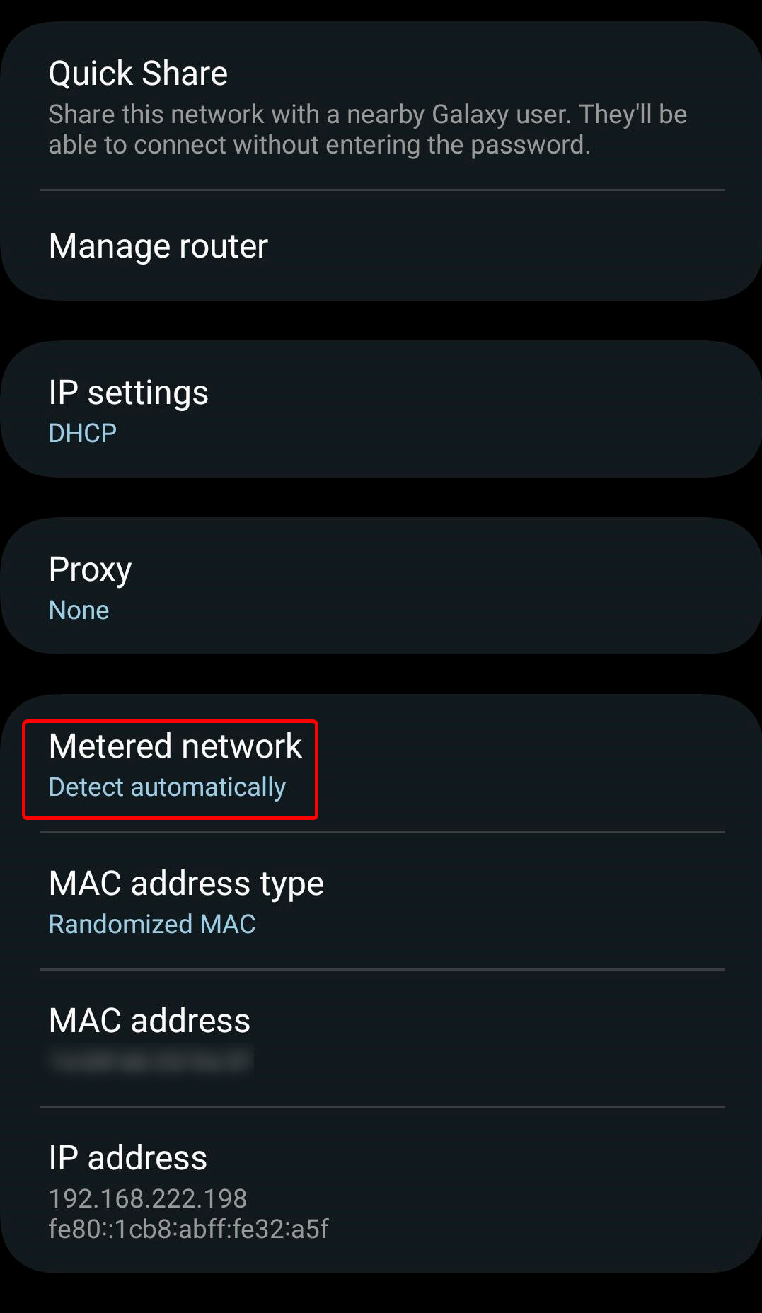

It is very unlikely that the RUT240 is causing this issue.
It seems like it could be an issue with the phone power saving settings or background data consumption limits.
The only thing I could suggest here, is in the WiFi network settings, change the “Metered network” option to Treat as unmetered:
If that does not help, I’d look deeper into the power/data saving settings of the mobile phone.

I have checked both telephones and they are both not restricted on downloading or power / data saving, moreover both on highest performance where ever possible.
Also, they work perfectly on other wifi networks which is why i ruled that out…
