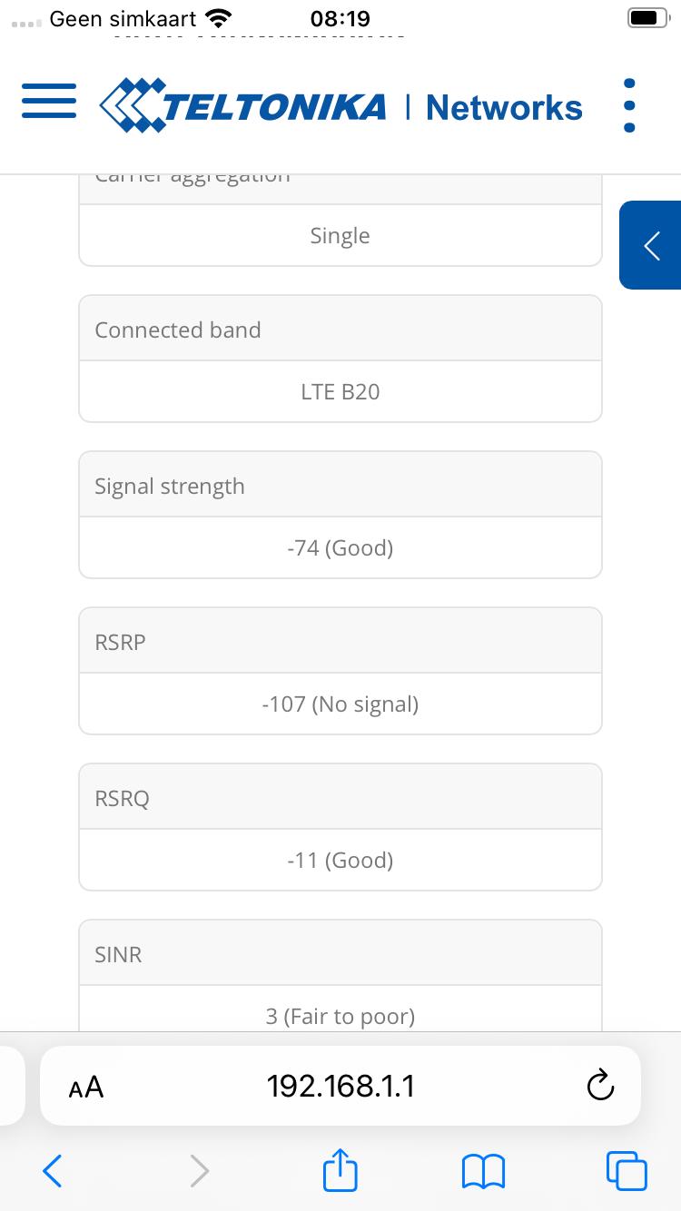

Data transmission:
see attached pic

From the screenshot you have attached, it seems that the RSRP and SINR is fairly poor (RSRP shows no signal). This can definately be the cause of slow internet connection. You can find more information about signal recommendations here.

For band selection, the decision of which band to connect to is made by the modem, not the RUT240. Teltonika doesn’t manufacture these modems, so we don’t have specifics on their selection logic. Generally, the device often connects to the band with the strongest signal. The screenshots indicate the device is connecting to LTE band 20 with a decent signal. However, other metrics, like RSRP and SINR, are not optimal.
