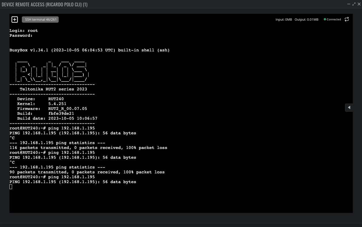

Could you kindly provide some System logs where the issue can be seen? System logs are available in System → Maintenance → Troubleshoot → View system logs. If there are any sensitive details, like public IP addresses, please ensure to redact or hide them before sharing the logs here.
Also, could you please try connecting to RUT and try pinging DUT from the CLI/SSH (username is ‘root’) or from the troubleshoot page in the WebUI (diagnostics section). Does it drop the packets?
It would also be great if you could access the device via CLI/SSH and share the output of the ifconfig command as well.

You system wont allow me to upload a zip file or more than 32k char. So I need to do it in multiple posts.
CLI ping

Oct 31 17:41:13 xl3 NetworkManager[85]: <warn>  [1698774073.9066] device (enx00e04c6802fe): Activation: failed for connection 'Wired connection 2'
Oct 31 17:41:13 xl3 NetworkManager[85]: <info>  [1698774073.9333] device (enx00e04c6802fe): state change: failed -> disconnected (reason 'none', sys-iface-state: 'managed')
Oct 31 17:41:13 xl3 NetworkManager[85]: <info>  [1698774073.9898] policy: auto-activating connection 'Wired connection 2' (63532478-23ea-33b2-95a7-a128b8bbe560)
Oct 31 17:41:14 xl3 NetworkManager[85]: <info>  [1698774073.9999] device (enx00e04c6802fe): Activation: starting connection 'Wired connection 2' (63532478-23ea-33b2-95a7-a128b8bbe560)
Oct 31 17:41:14 xl3 NetworkManager[85]: <info>  [1698774074.0013] device (enx00e04c6802fe): state change: disconnected -> prepare (reason 'none', sys-iface-state: 'managed')
Oct 31 17:41:14 xl3 NetworkManager[85]: <info>  [1698774074.0078] manager: NetworkManager state is now CONNECTING
Oct 31 17:41:14 xl3 NetworkManager[85]: <info>  [1698774074.0143] device (enx00e04c6802fe): state change: prepare -> config (reason 'none', sys-iface-state: 'managed')
Oct 31 17:41:14 xl3 NetworkManager[85]: <info>  [1698774074.0303] device (enx00e04c6802fe): state change: config -> ip-config (reason 'none', sys-iface-state: 'managed')
Oct 31 17:41:14 xl3 NetworkManager[85]: <info>  [1698774074.0514] dhcp4 (enx00e04c6802fe): activation: beginning transaction (timeout in 45 seconds)
Oct 31 17:41:14 xl3 NetworkManager[85]: <info>  [1698774074.1143] dhcp4 (enx00e04c6802fe): dhclient started with pid 6631
Oct 31 17:41:59 xl3 NetworkManager[85]: <warn>  [1698774119.8247] dhcp4 (enx00e04c6802fe): request timed out
Oct 31 17:41:59 xl3 NetworkManager[85]: <info>  [1698774119.8250] dhcp4 (enx00e04c6802fe): state changed unknown -> timeout
Oct 31 17:41:59 xl3 NetworkManager[85]: <info>  [1698774119.8417] dhcp4 (enx00e04c6802fe): canceled DHCP transaction, DHCP client pid 6631
Oct 31 17:41:59 xl3 NetworkManager[85]: <info>  [1698774119.8442] dhcp4 (enx00e04c6802fe): state changed timeout -> done
Oct 31 17:41:59 xl3 NetworkManager[85]: <info>  [1698774119.8551] device (enx00e04c6802fe): state change: ip-config -> failed (reason 'ip-config-unavailable', sys-iface-state: 'managed')
Oct 31 17:41:59 xl3 NetworkManager[85]: <info>  [1698774119.8624] manager: NetworkManager state is now CONNECTED_LOCAL
Oct 31 17:41:59 xl3 NetworkManager[85]: <warn>  [1698774119.8656] device (enx00e04c6802fe): Activation: failed for connection 'Wired connection 2'
Oct 31 17:41:59 xl3 NetworkManager[85]: <info>  [1698774119.8714] device (enx00e04c6802fe): state change: failed -> disconnected (reason 'none', sys-iface-state: 'managed')
Oct 31 17:46:59 xl3 NetworkManager[85]: <info>  [1698774419.8252] policy: auto-activating connection 'Wired connection 2' (63532478-23ea-33b2-95a7-a128b8bbe560)
Oct 31 17:46:59 xl3 NetworkManager[85]: <info>  [1698774419.8351] device (enx00e04c6802fe): Activation: starting connection 'Wired connection 2' (63532478-23ea-33b2-95a7-a128b8bbe560)
Oct 31 17:46:59 xl3 NetworkManager[85]: <info>  [1698774419.8410] device (enx00e04c6802fe): state change: disconnected -> prepare (reason 'none', sys-iface-state: 'managed')
Oct 31 17:46:59 xl3 NetworkManager[85]: <info>  [1698774419.8526] manager: NetworkManager state is now CONNECTING
Oct 31 17:46:59 xl3 NetworkManager[85]: <info>  [1698774419.8611] device (enx00e04c6802fe): state change: prepare -> config (reason 'none', sys-iface-state: 'managed')
Oct 31 17:46:59 xl3 NetworkManager[85]: <info>  [1698774419.8901] device (enx00e04c6802fe): state change: config -> ip-config (reason 'none', sys-iface-state: 'managed')
Oct 31 17:46:59 xl3 NetworkManager[85]: <info>  [1698774419.9131] dhcp4 (enx00e04c6802fe): activation: beginning transaction (timeout in 45 seconds)
Oct 31 17:46:59 xl3 NetworkManager[85]: <info>  [1698774419.9818] dhcp4 (enx00e04c6802fe): dhclient started with pid 6878
Oct 31 17:47:44 xl3 NetworkManager[85]: <warn>  [1698774464.8242] dhcp4 (enx00e04c6802fe): request timed out
Oct 31 17:47:44 xl3 NetworkManager[85]: <info>  [1698774464.8245] dhcp4 (enx00e04c6802fe): state changed unknown -> timeout
Oct 31 17:47:44 xl3 NetworkManager[85]: <info>  [1698774464.8386] dhcp4 (enx00e04c6802fe): canceled DHCP transaction, DHCP client pid 6878
Oct 31 17:47:44 xl3 NetworkManager[85]: <info>  [1698774464.8389] dhcp4 (enx00e04c6802fe): state changed timeout -> done
Oct 31 17:47:44 xl3 NetworkManager[85]: <info>  [1698774464.8510] device (enx00e04c6802fe): state change: ip-config -> failed (reason 'ip-config-unavailable', sys-iface-state: 'managed')
Oct 31 17:47:44 xl3 NetworkManager[85]: <info>  [1698774464.8630] manager: NetworkManager state is now CONNECTED_LOCAL
Oct 31 17:47:44 xl3 NetworkManager[85]: <warn>  [1698774464.8716] device (enx00e04c6802fe): Activation: failed for connection 'Wired connection 2'
Oct 31 17:47:44 xl3 NetworkManager[85]: <info>  [1698774464.8805] device (enx00e04c6802fe): state change: failed -> disconnected (reason 'none', sys-iface-state: 'managed')
Oct 31 17:47:44 xl3 NetworkManager[85]: <info>  [1698774464.9514] policy: auto-activating connection 'Wired connection 2' (63532478-23ea-33b2-95a7-a128b8bbe560)
Oct 31 17:47:44 xl3 NetworkManager[85]: <info>  [1698774464.9658] device (enx00e04c6802fe): Activation: starting connection 'Wired connection 2' (63532478-23ea-33b2-95a7-a128b8bbe560)
Oct 31 17:47:44 xl3 NetworkManager[85]: <info>  [1698774464.9725] device (enx00e04c6802fe): state change: disconnected -> prepare (reason 'none', sys-iface-state: 'managed')
Oct 31 17:47:44 xl3 NetworkManager[85]: <info>  [1698774464.9817] manager: NetworkManager state is now CONNECTING
Oct 31 17:47:44 xl3 NetworkManager[85]: <info>  [1698774464.9859] device (enx00e04c6802fe): state change: prepare -> config (reason 'none', sys-iface-state: 'managed')
Oct 31 17:47:45 xl3 NetworkManager[85]: <info>  [1698774465.0113] device (enx00e04c6802fe): state change: config -> ip-config (reason 'none', sys-iface-state: 'managed')
Oct 31 17:47:45 xl3 NetworkManager[85]: <info>  [1698774465.0330] dhcp4 (enx00e04c6802fe): activation: beginning transaction (timeout in 45 seconds)
Oct 31 17:47:45 xl3 NetworkManager[85]: <info>  [1698774465.0658] dhcp4 (enx00e04c6802fe): dhclient started with pid 6916
Oct 31 17:48:29 xl3 NetworkManager[85]: <warn>  [1698774509.8249] dhcp4 (enx00e04c6802fe): request timed out
Oct 31 17:48:29 xl3 NetworkManager[85]: <info>  [1698774509.8252] dhcp4 (enx00e04c6802fe): state changed unknown -> timeout
Oct 31 17:48:29 xl3 NetworkManager[85]: <info>  [1698774509.8483] dhcp4 (enx00e04c6802fe): canceled DHCP transaction, DHCP client pid 6916
Oct 31 17:48:29 xl3 NetworkManager[85]: <info>  [1698774509.8486] dhcp4 (enx00e04c6802fe): state changed timeout -> done
Oct 31 17:48:29 xl3 NetworkManager[85]: <info>  [1698774509.8561] device (enx00e04c6802fe): state change: ip-config -> failed (reason 'ip-config-unavailable', sys-iface-state: 'managed')
Oct 31 17:48:29 xl3 NetworkManager[85]: <info>  [1698774509.8652] manager: NetworkManager state is now CONNECTED_LOCAL
Oct 31 17:48:29 xl3 NetworkManager[85]: <warn>  [1698774509.8752] device (enx00e04c6802fe): Activation: failed for connection 'Wired connection 2'
Oct 31 17:48:29 xl3 NetworkManager[85]: <info>  [1698774509.8835] device (enx00e04c6802fe): state change: failed -> disconnected (reason 'none', sys-iface-state: 'managed')
Oct 31 17:48:29 xl3 NetworkManager[85]: <info>  [1698774509.9452] policy: auto-activating connection 'Wired connection 2' (63532478-23ea-33b2-95a7-a128b8bbe560)
Oct 31 17:48:29 xl3 NetworkManager[85]: <info>  [1698774509.9664] device (enx00e04c6802fe): Activation: starting connection 'Wired connection 2' (63532478-23ea-33b2-95a7-a128b8bbe560)
Oct 31 17:48:29 xl3 NetworkManager[85]: <info>  [1698774509.9724] device (enx00e04c6802fe): state change: disconnected -> prepare (reason 'none', sys-iface-state: 'managed')
Oct 31 17:48:29 xl3 NetworkManager[85]: <info>  [1698774509.9925] manager: NetworkManager state is now CONNECTING
Oct 31 17:48:30 xl3 NetworkManager[85]: <info>  [1698774510.0043] device (enx00e04c6802fe): state change: prepare -> config (reason 'none', sys-iface-state: 'managed')
Oct 31 17:48:30 xl3 NetworkManager[85]: <info>  [1698774510.0660] device (enx00e04c6802fe): state change: config -> ip-config (reason 'none', sys-iface-state: 'managed')
Oct 31 17:48:30 xl3 NetworkManager[85]: <info>  [1698774510.0830] dhcp4 (enx00e04c6802fe): activation: beginning transaction (timeout in 45 seconds)
Oct 31 17:48:30 xl3 NetworkManager[85]: <info>  [1698774510.1331] dhcp4 (enx00e04c6802fe): dhclient started with pid 6955
Oct 31 17:49:15 xl3 NetworkManager[85]: <warn>  [1698774555.8250] dhcp4 (enx00e04c6802fe): request timed out
Oct 31 17:49:15 xl3 NetworkManager[85]: <info>  [1698774555.8253] dhcp4 (enx00e04c6802fe): state changed unknown -> timeout
Oct 31 17:49:15 xl3 NetworkManager[85]: <info>  [1698774555.8461] dhcp4 (enx00e04c6802fe): canceled DHCP transaction, DHCP client pid 6955
Oct 31 17:49:15 xl3 NetworkManager[85]: <info>  [1698774555.8464] dhcp4 (enx00e04c6802fe): state changed timeout -> done
Oct 31 17:49:15 xl3 NetworkManager[85]: <info>  [1698774555.8525] device (enx00e04c6802fe): state change: ip-config -> failed (reason 'ip-config-unavailable', sys-iface-state: 'managed')
Oct 31 17:49:15 xl3 NetworkManager[85]: <info>  [1698774555.8808] manager: NetworkManager state is now CONNECTED_LOCAL
Oct 31 17:49:15 xl3 NetworkManager[85]: <warn>  [1698774555.8951] device (enx00e04c6802fe): Activation: failed for connection 'Wired connection 2'
Oct 31 17:49:15 xl3 NetworkManager[85]: <info>  [1698774555.9052] device (enx00e04c6802fe): state change: failed -> disconnected (reason 'none', sys-iface-state: 'managed')
Oct 31 17:49:15 xl3 NetworkManager[85]: <info>  [1698774555.9843] policy: auto-activating connection 'Wired connection 2' (63532478-23ea-33b2-95a7-a128b8bbe560)
Oct 31 17:49:16 xl3 NetworkManager[85]: <info>  [1698774556.0005] device (enx00e04c6802fe): Activation: starting connection 'Wired connection 2' (63532478-23ea-33b2-95a7-a128b8bbe560)
Oct 31 17:49:16 xl3 NetworkManager[85]: <info>  [1698774556.0130] device (enx00e04c6802fe): state change: disconnected -> prepare (reason 'none', sys-iface-state: 'managed')
Oct 31 17:49:16 xl3 NetworkManager[85]: <info>  [1698774556.0310] manager: NetworkManager state is now CONNECTING
Oct 31 17:49:16 xl3 NetworkManager[85]: <info>  [1698774556.0410] device (enx00e04c6802fe): state change: prepare -> config (reason 'none', sys-iface-state: 'managed')
Oct 31 17:49:16 xl3 NetworkManager[85]: <info>  [1698774556.0734] device (enx00e04c6802fe): state change: config -> ip-config (reason 'none', sys-iface-state: 'managed')
Oct 31 17:49:16 xl3 NetworkManager[85]: <info>  [1698774556.1074] dhcp4 (enx00e04c6802fe): activation: beginning transaction (timeout in 45 seconds)
Oct 31 17:49:16 xl3 NetworkManager[85]: <info>  [1698774556.1624] dhcp4 (enx00e04c6802fe): dhclient started with pid 6994
Oct 31 17:50:01 xl3 NetworkManager[85]: <warn>  [1698774601.8250] dhcp4 (enx00e04c6802fe): request timed out
Oct 31 17:50:01 xl3 NetworkManager[85]: <info>  [1698774601.8253] dhcp4 (enx00e04c6802fe): state changed unknown -> timeout
Oct 31 17:50:01 xl3 NetworkManager[85]: <info>  [1698774601.8417] dhcp4 (enx00e04c6802fe): canceled DHCP transaction, DHCP client pid 6994
Oct 31 17:50:01 xl3 NetworkManager[85]: <info>  [1698774601.8420] dhcp4 (enx00e04c6802fe): state changed timeout -> done
Oct 31 17:50:01 xl3 NetworkManager[85]: <info>  [1698774601.8521] device (enx00e04c6802fe): state change: ip-config -> failed (reason 'ip-config-unavailable', sys-iface-state: 'managed')
Oct 31 17:50:01 xl3 NetworkManager[85]: <info>  [1698774601.8963] manager: NetworkManager state is now CONNECTED_LOCAL
Oct 31 17:50:01 xl3 NetworkManager[85]: <warn>  [1698774601.9222] device (enx00e04c6802fe): Activation: failed for connection 'Wired connection 2'
Oct 31 17:50:01 xl3 NetworkManager[85]: <info>  [1698774601.9409] device (enx00e04c6802fe): state change: failed -> disconnected (reason 'none', sys-iface-state: 'managed')
Oct 31 17:55:01 xl3 NetworkManager[85]: <info>  [1698774901.8254] policy: auto-activating connection 'Wired connection 2' (63532478-23ea-33b2-95a7-a128b8bbe560)
Oct 31 17:55:01 xl3 NetworkManager[85]: <info>  [1698774901.8406] device (enx00e04c6802fe): Activation: starting connection 'Wired connection 2' (63532478-23ea-33b2-95a7-a128b8bbe560)
Oct 31 17:55:01 xl3 NetworkManager[85]: <info>  [1698774901.8459] device (enx00e04c6802fe): state change: disconnected -> prepare (reason 'none', sys-iface-state: 'managed')
Oct 31 17:55:01 xl3 NetworkManager[85]: <info>  [1698774901.8629] manager: NetworkManager state is now CONNECTING
Oct 31 17:55:01 xl3 NetworkManager[85]: <info>  [1698774901.8728] device (enx00e04c6802fe): state change: prepare -> config (reason 'none', sys-iface-state: 'managed')
Oct 31 17:55:01 xl3 NetworkManager[85]: <info>  [1698774901.9026] device (enx00e04c6802fe): state change: config -> ip-config (reason 'none', sys-iface-state: 'managed')
Oct 31 17:55:01 xl3 NetworkManager[85]: <info>  [1698774901.9151] dhcp4 (enx00e04c6802fe): activation: beginning transaction (timeout in 45 seconds)
Oct 31 17:55:01 xl3 NetworkManager[85]: <info>  [1698774901.9504] dhcp4 (enx00e04c6802fe): dhclient started with pid 7241
Oct 31 17:55:46 xl3 NetworkManager[85]: <warn>  [1698774946.8250] dhcp4 (enx00e04c6802fe): request timed out
Oct 31 17:55:46 xl3 NetworkManager[85]: <info>  [1698774946.8253] dhcp4 (enx00e04c6802fe): state changed unknown -> timeout
Oct 31 17:55:46 xl3 NetworkManager[85]: <info>  [1698774946.8515] dhcp4 (enx00e04c6802fe): canceled DHCP transaction, DHCP client pid 7241
Oct 31 17:55:46 xl3 NetworkManager[85]: <info>  [1698774946.8518] dhcp4 (enx00e04c6802fe): state changed timeout -> done
Oct 31 17:55:46 xl3 NetworkManager[85]: <info>  [1698774946.8604] device (enx00e04c6802fe): state change: ip-config -> failed (reason 'ip-config-unavailable', sys-iface-state: 'managed')
Oct 31 17:55:46 xl3 NetworkManager[85]: <info>  [1698774946.9039] manager: NetworkManager state is now CONNECTED_LOCAL
Oct 31 17:55:46 xl3 NetworkManager[85]: <warn>  [1698774946.9239] device (enx00e04c6802fe): Activation: failed for connection 'Wired connection 2'
Oct 31 17:55:46 xl3 NetworkManager[85]: <info>  [1698774946.9410] device (enx00e04c6802fe): state change: failed -> disconnected (reason 'none', sys-iface-state: 'managed')
Oct 31 17:55:46 xl3 NetworkManager[85]: <info>  [1698774946.9917] policy: auto-activating connection 'Wired connection 2' (63532478-23ea-33b2-95a7-a128b8bbe560)
Oct 31 17:55:47 xl3 NetworkManager[85]: <info>  [1698774947.0012] device (enx00e04c6802fe): Activation: starting connection 'Wired connection 2' (63532478-23ea-33b2-95a7-a128b8bbe560)
Oct 31 17:55:47 xl3 NetworkManager[85]: <info>  [1698774947.0024] device (enx00e04c6802fe): state change: disconnected -> prepare (reason 'none', sys-iface-state: 'managed')
Oct 31 17:55:47 xl3 NetworkManager[85]: <info>  [1698774947.0059] manager: NetworkManager state is now CONNECTING
Oct 31 17:55:47 xl3 NetworkManager[85]: <info>  [1698774947.0119] device (enx00e04c6802fe): state change: prepare -> config (reason 'none', sys-iface-state: 'managed')
Oct 31 17:55:47 xl3 NetworkManager[85]: <info>  [1698774947.0236] device (enx00e04c6802fe): state change: config -> ip-config (reason 'none', sys-iface-state: 'managed')
Oct 31 17:55:47 xl3 NetworkManager[85]: <info>  [1698774947.0326] dhcp4 (enx00e04c6802fe): activation: beginning transaction (timeout in 45 seconds)
Oct 31 17:55:47 xl3 NetworkManager[85]: <info>  [1698774947.0626] dhcp4 (enx00e04c6802fe): dhclient started with pid 7279
Oct 31 17:56:24 xl3 NetworkManager[85]: <info>  [1698774984.1810] device (enx00e04c6802fe): state change: ip-config -> unavailable (reason 'carrier-changed', sys-iface-state: 'managed')
Oct 31 17:56:24 xl3 NetworkManager[85]: <info>  [1698774984.2001] dhcp4 (enx00e04c6802fe): canceled DHCP transaction, DHCP client pid 7279
Oct 31 17:56:24 xl3 NetworkManager[85]: <info>  [1698774984.2004] dhcp4 (enx00e04c6802fe): state changed unknown -> done
Oct 31 17:56:24 xl3 NetworkManager[85]: <info>  [1698774984.2310] manager: NetworkManager state is now CONNECTED_LOCAL
Oct 31 17:56:32 xl3 NetworkManager[85]: <info>  [1698774992.2205] device (enx00e04c6802fe): carrier: link connected
Oct 31 17:56:32 xl3 NetworkManager[85]: <info>  [1698774992.2399] device (enx00e04c6802fe): state change: unavailable -> disconnected (reason 'carrier-changed', sys-iface-state: 'managed')
Let me know how could I send you the full logs.
