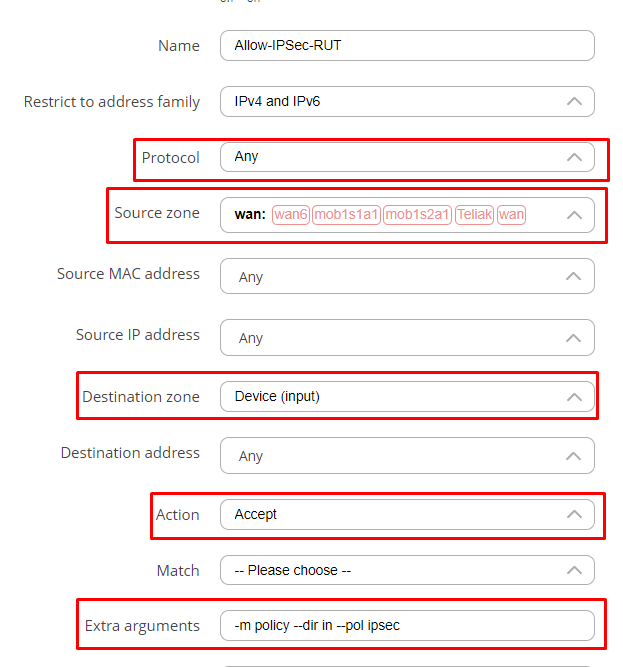

The firewall rules should be automatically generated to reach the LAN network. However, you may want to add another firewall rule to allow IPSec access to the device itself. For this, navigate to Network → Firewall → Traffic Rules and create a new rule at the bottom. To match IPSec traffic to the device, select WAN as the source zone, ‘Device (input)’ as the destination, and add the following to the ‘extra arguments’ field:
  • -m policy --dir in --pol ipsec
Here’s a screenshot for reference:

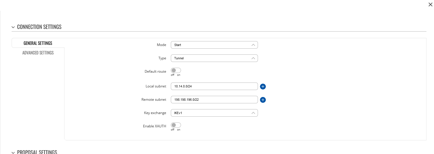

yes in the VPN Settings i defined the hole Subnet. this is a Screenshoot:
I added the Firewall Traffic rule but still not working
