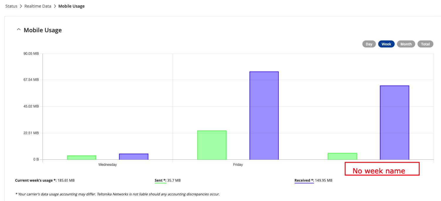

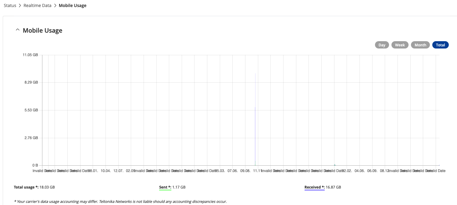

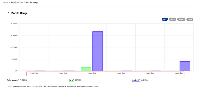

If I go to “Status → Realtime Data → Mobile Usage
It looks like that the data is invalid, it shows “Invalid Date”.
Month view
Week View
Day View
Total View

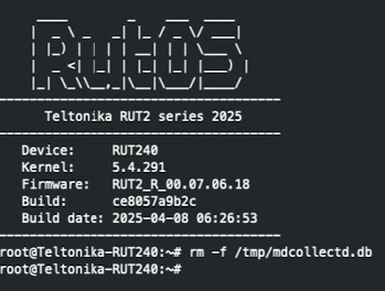

If this doesn’t resolve the issue, try deleting the mdcollectd.db file from the router’s /tmp directory by executing the following command via CLI and rebooting the router:
rm -f /tmp/mdcollectd.db
Let me know how it goes.
Browser Language is German (DE)
I switched to English (US) and cleared the Cache → no change
I switched back to German (DE) and cleared the Cache → no change
I run
no change

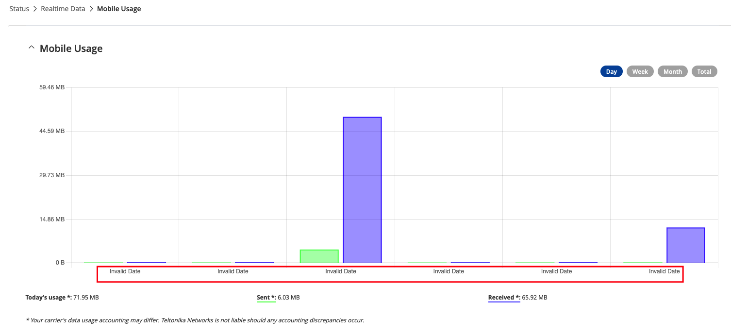

I switched again to English (US) → no change
Also no change after a Power Cycle
