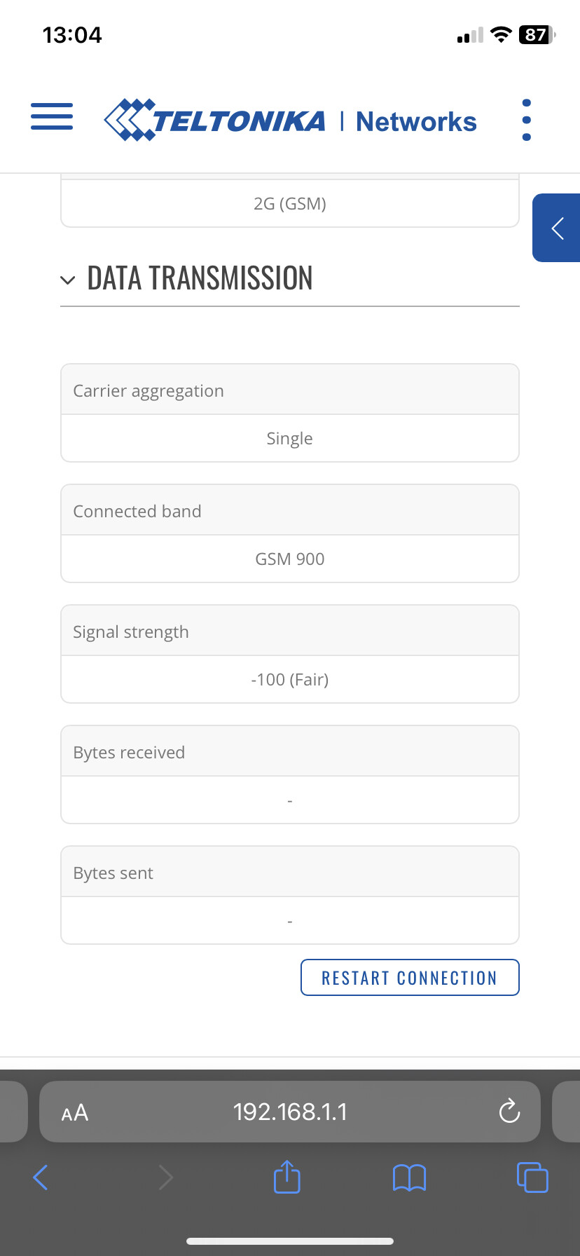

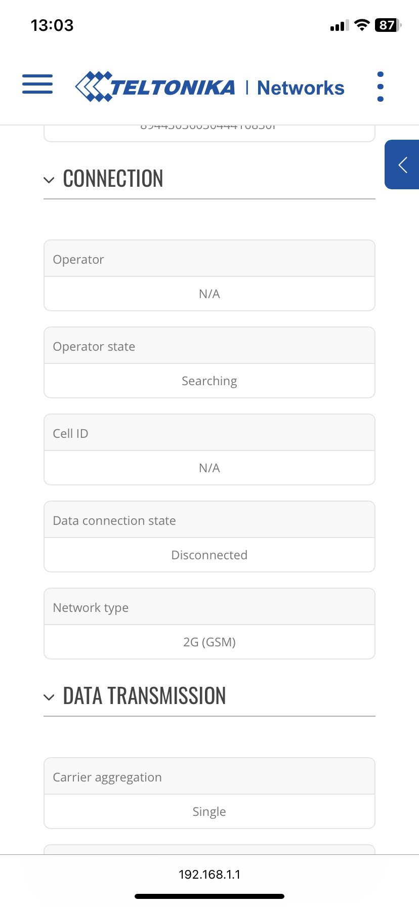

Please find images attached.

Since I can’t see any obvious issues in the provided screenshots, I would assume that the issue is indeed caused by the low signal strength. As mentioned, make sure the router is in an open area, then set the service mode to 4G-only (Network → Mobile → General Settings), wait around a minute, and take the same screenshots as in the last comments. Additionally, it would be good if the router could be tested in an area with a better signal coverage.
