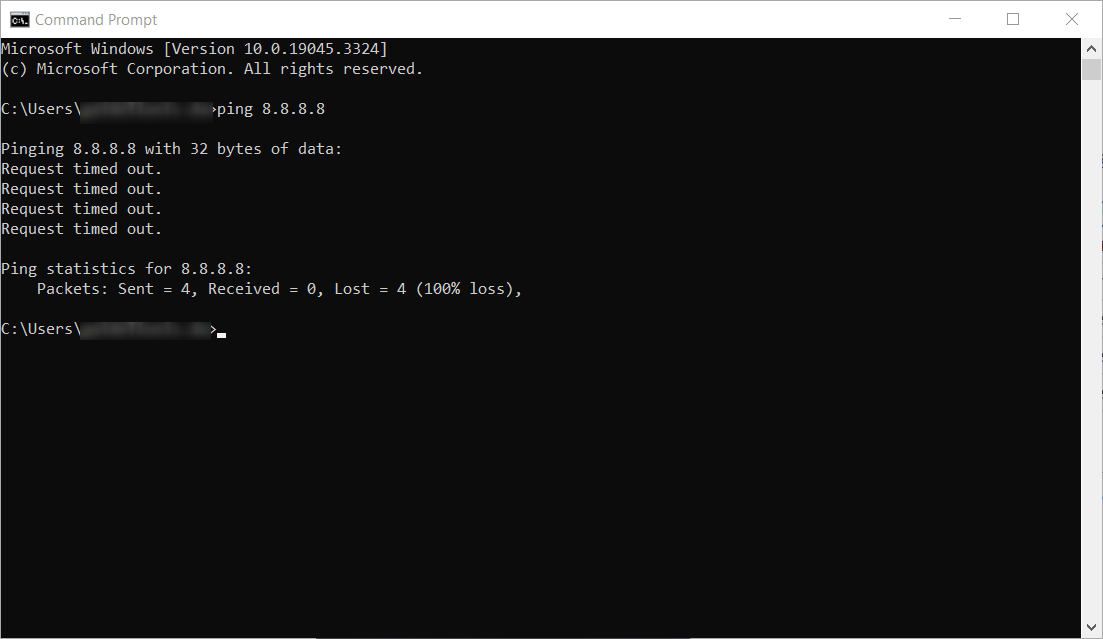

To test the ping functionality, open the CMD window. It will look like so in the Windows search:
When a black command window shows up, run this command:
ping 8.8.8.8
The result should look like so if there is internet connection available:
And like so if there is no internet (could take a while):

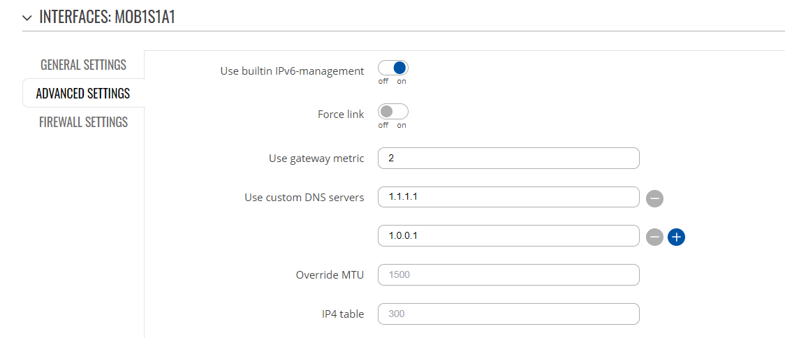

Most likely your carrier is supplying invalid or unreachable DNS addresses. In this case, the easiest way to solve the issue would be by manually selecting the DNS.
  • Log into the WebUI of the RUT240;
  • Navigate to Network → Interfaces → General;
  • Edit the mob1s1a1 interface by pressing the pencil icon;
  • In the advanced settings, add 1.1.1.1 and 1.0.0.1 under the Use custom DNS servers:
You may need to reconnect to the WiFi network for the changes to take effect. The addresses of the mentioned DNS service are provided by Cloudflare.
Let me know if this helps!
