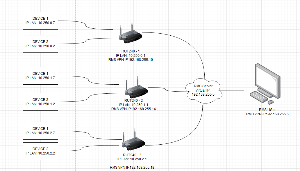

I currently have the topology used as shown in the figure. - firmawe version RUT2 R 00.07.04.5
Being connected to RMS server via OpenVPN client I am able to ping LAN devices e.g. 10.250.0.7. On the other hand I am no longer able to log in via https://10.250.0.7 from RMS user.
The second problem I encountered is the inability to add to static routes devices with addresses 10.250.1.2, 10.250.2.2 - I can ping other device from this LAN network.
With autoscan I do not find these devices. I can add them manually, but the devices are not pinged.
I should add that I have no problems with 10.250.0.2.

The static routes for the entire network did not work. However, changing the netmask from 255.255.255.0 to 255.255.255.255 helped. Now I can ping all devices.
There is still the issue of logging into the devices over https from the RMS User.

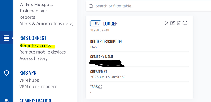

I can log into device using RMS connect - Unfortunately, after a few seconds I lose communication with the device
On the other hand, I would like to be able to use the device from the RMS User. Could you please guide me where I should look for the problem?

If the device with IP address 10.250.0.7 is a third-party device, it can be accessed using RMS Connect (as per the screenshot), or via VPN Hubs. Please clarify which feature you are experiencing difficulties with.
Does the issue with RMS Connect only occur when using port 443 (as opposed to 80)?

I have a problem with two feature:
-RMS connect - I can connect to the device via https, log on to it, while every time after 10 seconds it kicks me out and I have to repeat the procedure
