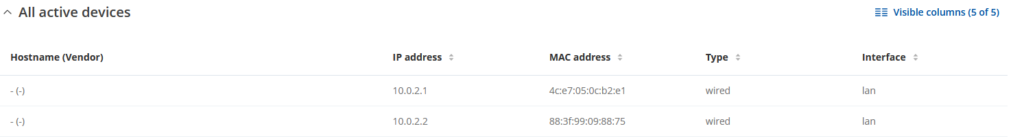

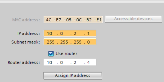

The LAN side devices, A and B, have IPs 10.0.2.1 and 10.0.2.2, both have the gateway address assigned to 10.0.2.4, so as depicted here:

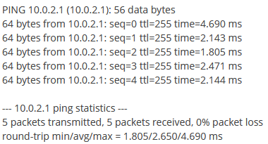

My devices A and B are connected, I can ping them from the router, but the network address translation does not work, as when I ping from a device on WAN side (via addresses 10.0.1.51 and 10.0.1.52), no response comes.

Nothing seems to work. When I try to ping from the WAN interface, no traffic is recorded on the LAN side, unlike when I ping the device IPs directly from the router, so I know that there is a problem in the router at least.
