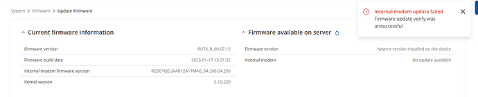

For over a month the internal modem firmware gives error message when trying to update through the gui.
How can I get this resolved?

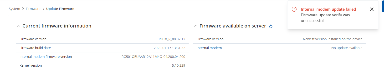

Updated the firmware and still the same continues. Also previosly updated multiple versions with the issue continuing with the modem fw update.

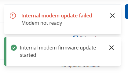

No wired connection available. I know it worked before as have updated it multiple times prior to this fw version.
