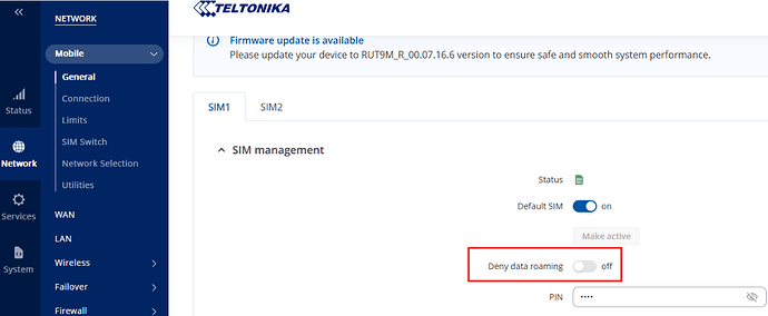

  • Go to Network → Mobile → General and make sure Deny data roaming is off

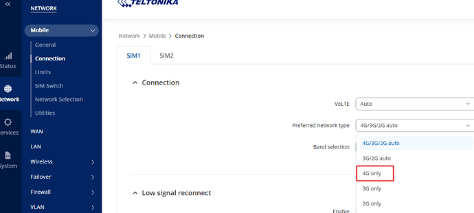

  • Go to Network → Connection and change the preferred network type to 4G only.

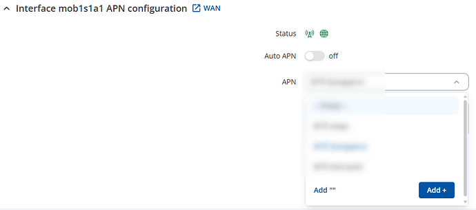

  • Ensure you have the correct APN set up for the sim card, if you have it set on Auto currently, try to input it manually according to your carrier.
    Go to Network → Mobile → General and on the bottom of your page you will be able to edit the APN configuration, turn off Auto APN and press Add new, then you will be able to type the APN in.
