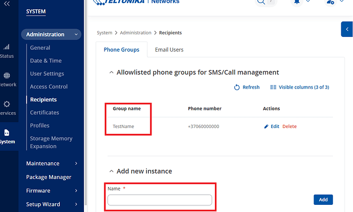

Regarding the name field, it is possible to enter a name for a single phone number or for a group of phone numbers.
For filtering options, you can create a custom script to specify recipients and use crontabs to schedule when messages should be received. More information can be found here:
Additionally, thank you for suggesting this feature for WebUI. I will forward your suggestion to our development team.
Hello
Thank you for the information, Regarding the names, I meant when more than one phone, to include the name, rather than the group’s name.
I will check the crontab to see how to create the 2 groups and swap between them.
