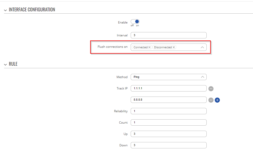

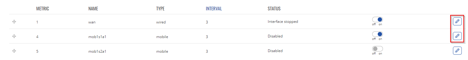

To resolve your issue, I suggest enabling the “flush connections on” option for your failover. You can do this by navigating to the router’s WebUI, then go to Network > Failover. Next, click the edit button for both your mobile interface and access point interface.
In the pop-up window, you will find the “flush connections on” option. Simply select both options from the list, “connected” and “disconnected”, then press save and apply. This should help resolve the issue.
It’s important to note that you should perform these steps on both of your failover interfaces.
If this solution doesn’t yield the desired results, please provide me with screenshots of your configurations. However, please be cautious when sharing screenshots to ensure that there is no confidential information or credentials included in them.
