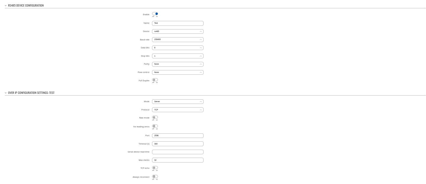

I also attached pictures of the Serial over IP config page.

The highest supported baud rate for RUT956 is 115200. Could you try lowering the baud rate of the serial device and checking if the OverIP feature works then?
Additionally, for higher baud rates we recommend avoiding the use of longer cables. If half-duplex connection is used, make sure to bridge the pins 1 and 2, as well as 4 and 5 on the 6-pin RS485 connector. More information can be found here: RUT956 Serial Utilities - Teltonika Networks Wiki
