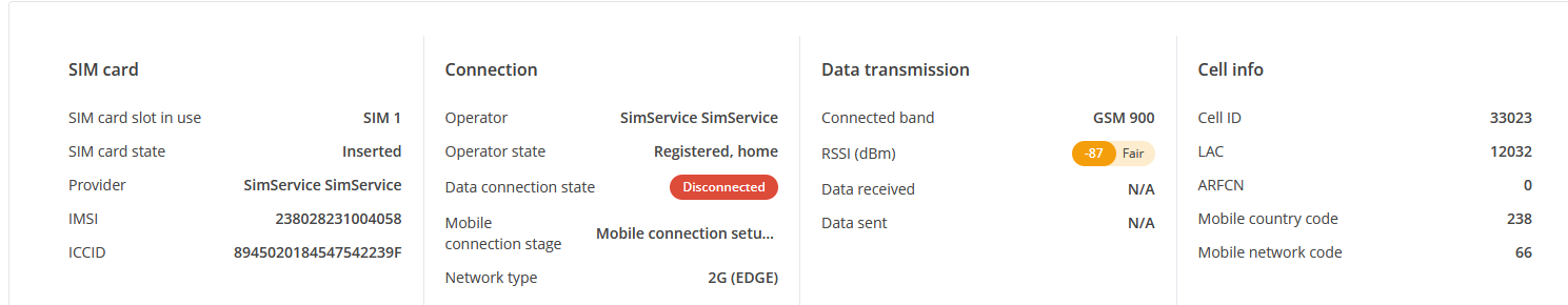

I have a problem with a RUT 955, it works alomost as it should, my only problem is that the DATA connection in the internal modem to the sim card is disconnected.
I have tried to do all I know I have the newest firmware, tried to factory reset it, change sim ports.
It can register that there are a Sim in it and it works, I can even Ping the sim and router.
So I feel I am lost does anyone have some guidance?
Hello, are all mobile antennas attached? Because from provided screenshots I can see it only connects to 2G network.
If antennas attached, try setting custom APN (Network->Mobile->General page).
Also can go to Network->Mobile->Connection page and try to set network type to 4G only.
