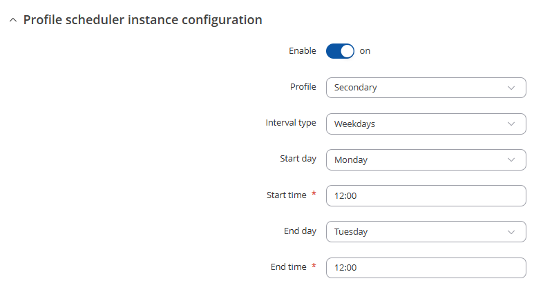

A custom script is unnecessary to automate switching between multiple configuration profiles.
The router has a feature called Profile Scheduler, which you can utilize to configure the device to use a particular profile at a particular time.
Once you have multiple configuration profile instances, navigate to System -> Administration -> Profiles
page and switch to Profile Scheduler
tab.
After you enable this functionality and add a scheduler instance, you will be prompted with a configuration window to adjust when you want the device to use a specific profile. For example:
