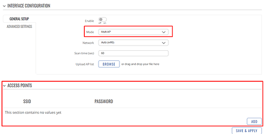

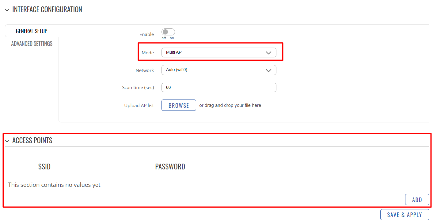

For multi AP, simply create a new instance by pressing the add button, then in the new window change the mode to Multi AP. Information here.

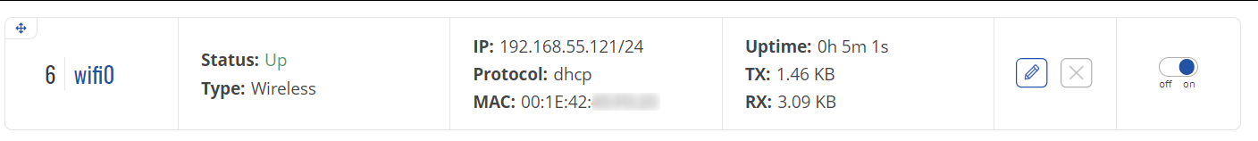

Thank you. I have installed Travelmate and successfully scaned and joined a single hot spot.

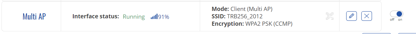

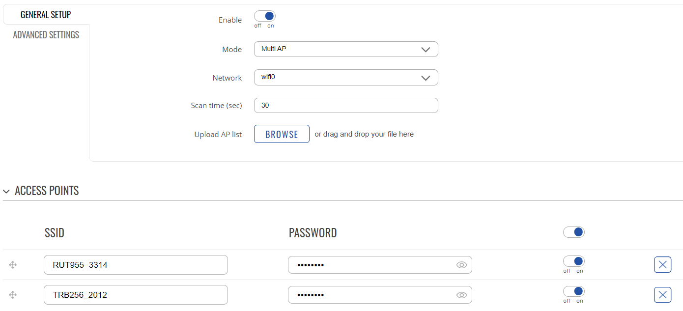

So I deleted this instance and created a new one manually adding the SSID and PHRASE. Changed the mode to MULTI. This worked.
However it doesn’t seem possible to then use the SCAN feature from the main screen. Selecting SCAN it won’t let you JOIN another hotspot.
Selecting the MULTI instance I can manually ADD another SSID. But there is no SCAN facility on that screen only ADD / BROWSE.
So I have got it working but only in add manual mode not using the SCAN for Multi AP.
