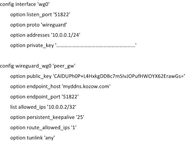

according to your instructions. I have also tried to modify my Wireguard config file based on your proposal and ChatGPT instructions. I still cannot achieve a connection between the two nodes communicating via RUT 240. I am very close to give up. My final attempt is to show you the config file that I have used and if you can see any obvious errors in the configuration, that ChatGPT does not understand. Are there any other setup in RUT240 that need to be configured, besides the DDNS and Port Forwards. I am using UDP and not LTE. For your further information, I had no problems to communicate via Wireguard between the two nodes alone before I also included RUT 240 into the communication chain. I tried to upload the png-file below.
Two remarks:
  • as the RUT is the initiator the option listen_port ‘51822’ isn’t required just delete the line wireguard will use a random port
  • the list allowed_ips ‘10.0.0.2/32’ seems overly restrictive could you try with 10.0.0.0/24 instead ?
You need to ensure that the peer settings on the RUT reflects the settings on your Pi.
For example, is your Pi listening on port 51822 or is it listening on the wireguard default port of 51820. This is the ‘endpoint_port’ setting on your RUT
As I said in my previous comment, “… you will have to ammend it according to your config”

Thanks for the remarks. Unfortunately, no difference in the result.
Right, I have worked intense to make the settings correct on all three nodes, including the RUT 240. When the 51820 didn’t work, we thought changing to 51821, but then I saw you used 51822 in your example, so I tried that instead. It still doesn’t work.
